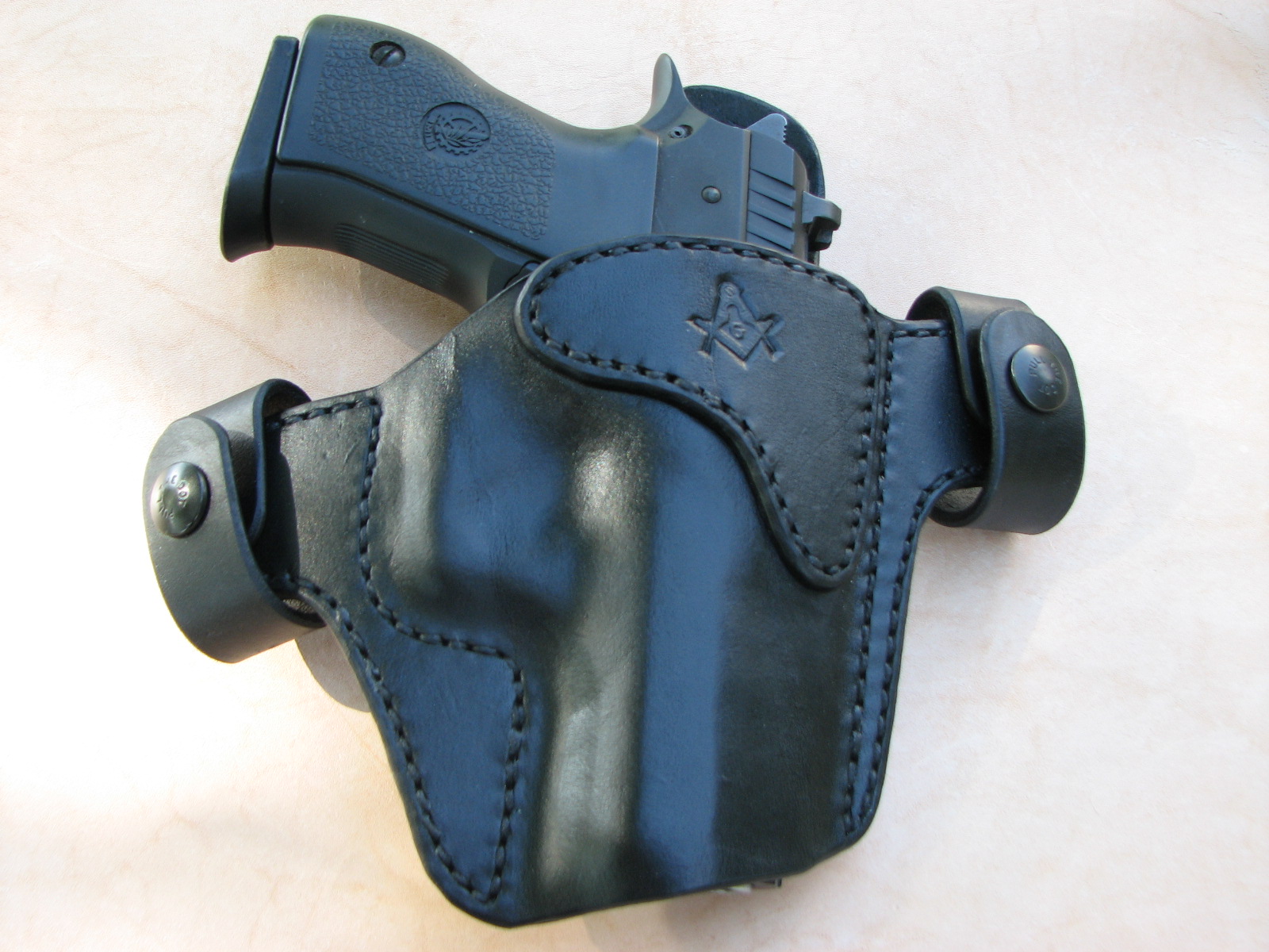

I recently put a pic of a holster on here and got a lot of good feedback. Here is the next holster made for another brother.
:whatdoyouthink: Thanks, Carl

Looks alright to me. Next time you might want to leave a little more room for your finger where the trigger guard meets the grip/frame. You need to be able to get a complete grip on the pistol while it is still in the holster for a good strong draw.

The image below is what BOOMSTICK is talking about. Gotta have an area to get a good grip.
The holster looks good brother Carl. I am going to try a holster with the same kind of loops ,are the belt loops held on only buy the back part of the snap, or do you use some Cement ?
#6 screw through the male part of the snap into a T-nut inserted into the back of the holster. These straps can be swapped out with others to be worn IWB or OWB.
