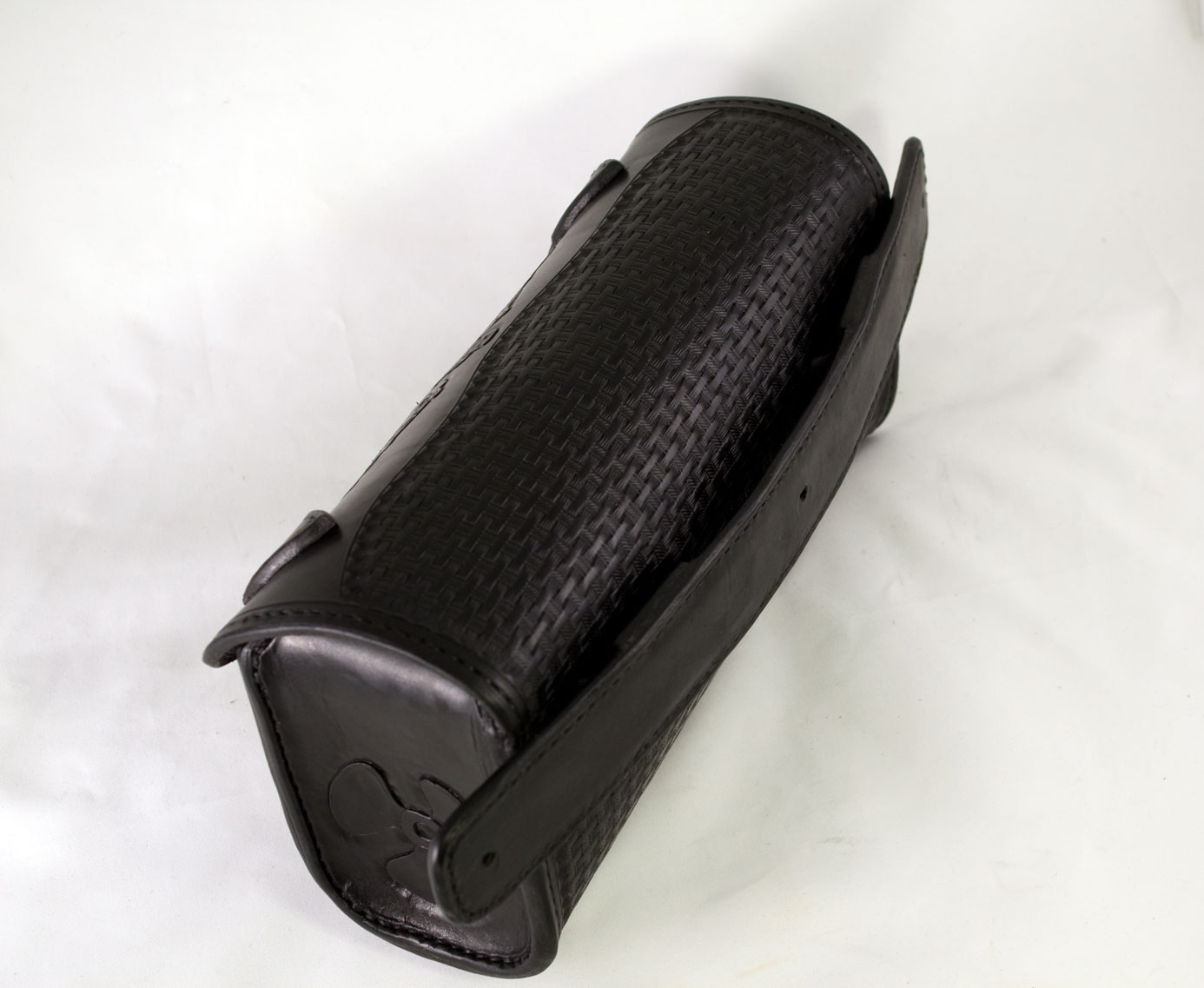

Hey guys been working on a windshield bag for a guy at work thats gonna go on his roadking.
Ill get the rest of the pics should be done today or tomorrow.
Basically used the pattern pack for the fork bag but we made a bracket and Im covering that with leather. Its gonna be black so figured I would post a couple of shots of the tooling.
I was happy with the basketweave but the screws I could of done better on I think. The dolphins were ok. Oh and for anyone that doesnt know the dolphins are what submariners get when they are finished with there qualifications. Most countries have some semplence of them for there submarine fleet.

Lets just say I broke it up into two days of tooling. I think I need to widen my grips on my tools. My big hands dont like gripping those little stamp handles.
I have big arthritic mitts
I also have fuel line grips on my most used stamps ;0) Varied sizes of line to friction fit ove the tool handle - let's me loosen my grip on it a bit while stamping and not so much cramping etc after
Hairspray on the stamp handle will help ya slide tight fuel line over it and acts like glue once it dries ;)
Thats a darn good idea McJeep. Thanks
And thanks Ian and Tim, he seemed to like the pictures of it so far so hopefully Ill get it all put together this week.
Well dont know how to edit the first post, wanted to change the title to windsheild bag finished but oh well.
Anyways got her done, fingers are sore lol. I need a sewing machine.
The mounting portion is a piece of aluminum that was cut bent and drilled to follow the contour of the windshield. I covered it with leather and included to strap guides I guess you could call them. This allowed the bag to retain the standard fork mounting setup but be attached to the windshield. The strap is a little long but allows for diversity in set up so he can mount it somewhere else if he decides to.
Most of the black is vinegaroon. Had to touch up the black for the edges and where I tooled becuase there the vinee couldnt soak thru all the way. The inside lining came out a nice grey color so I chose to leave it as is. Made for a nice contrast between the dark black of the outside and the inside. Looks good in person.
Enjoy. Was playing with camera so got alot of pics lol,
Way nice! I bet your fingers are sore - there's a reason the one I did got braided - no way can I hand stitch that much.
Vurrrrrrry nassssssssssssssss :)
What type of leather did you use for the linning? It came out really nice, and the edge burnishing is awesome!
Thanks,
the lining is that vegtan tooling calf, I think about 2/3oz. I vinegarooned it just like the outside stuff and ended up getting that grey color. Worked out pretty good for the finished product.
I also oiled it, leather balm with atom wax, then a coat of sno seal. Incase your interested.
