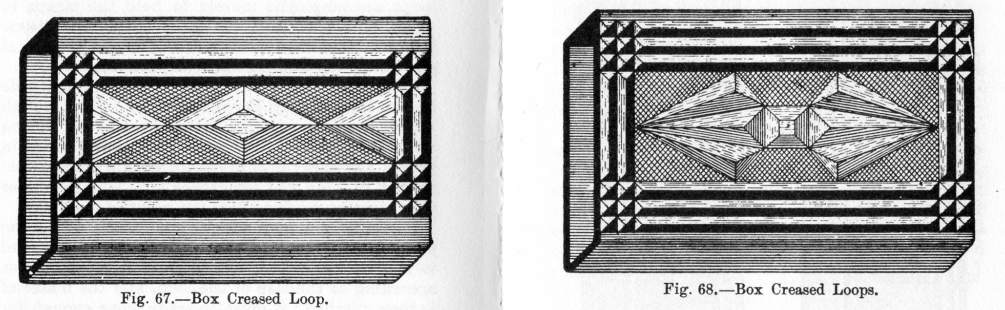

Loops on harness-work would sometimes be skilfully creased with ornate patterns, and were small masterpieces (pics below).
