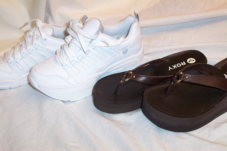

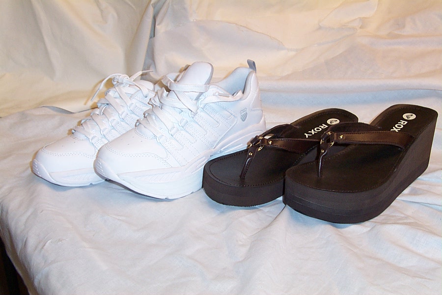

Hi rickybobby, nice job. I do this on a dailly basis on all type of footwear and thank god someone else removes the original sole and reuses it. I also do covered raises in the best match to upper as possible.
a couple of pics.
a couple of pics.
Nice work you do! It appears you used a cork base for the lift and covered it? I have never used cork or done that high of lift. I have done 1/4" to 1 1/4" lifts and used "cloud "material.
