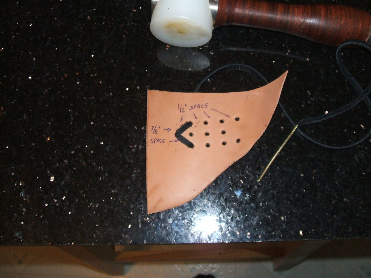

Is there anyone who will explain to me how to do the laceing that attaches the back strap to the leg of the chaps that looks kind of like a chevron?

Anne, give me five minutes or so and I'll do a demo and take picture for you.

Okay here ya go, took a bit more that 5 minutes but I hope it helps you out. I just used the 1/2" and 3/8" spacing for a demo, but you can decide what your spacing should be.
Good luck.

Anne,
here is a quick explanation with pictures. hope it helps.
Start by punching holes in three rows. The middle row is offset by one. The holes need to match up on belt piece and chap top.
Start lace from back side of belt piece going through row one hole one and row three hole one.
Repeat on chap top so that both are together.
bring both ends of lace together and go through row two hole one. This will complete the first line of the design. repeat untill finished bring lace ends back through on back side to secure.
Good luck.
Thank you so very much I will be up late tonight trying to get these done and the fringe cut.
People on this list are so great!!!

Clay, YOU RULE....yours works much better than what I came up with. Great job.
