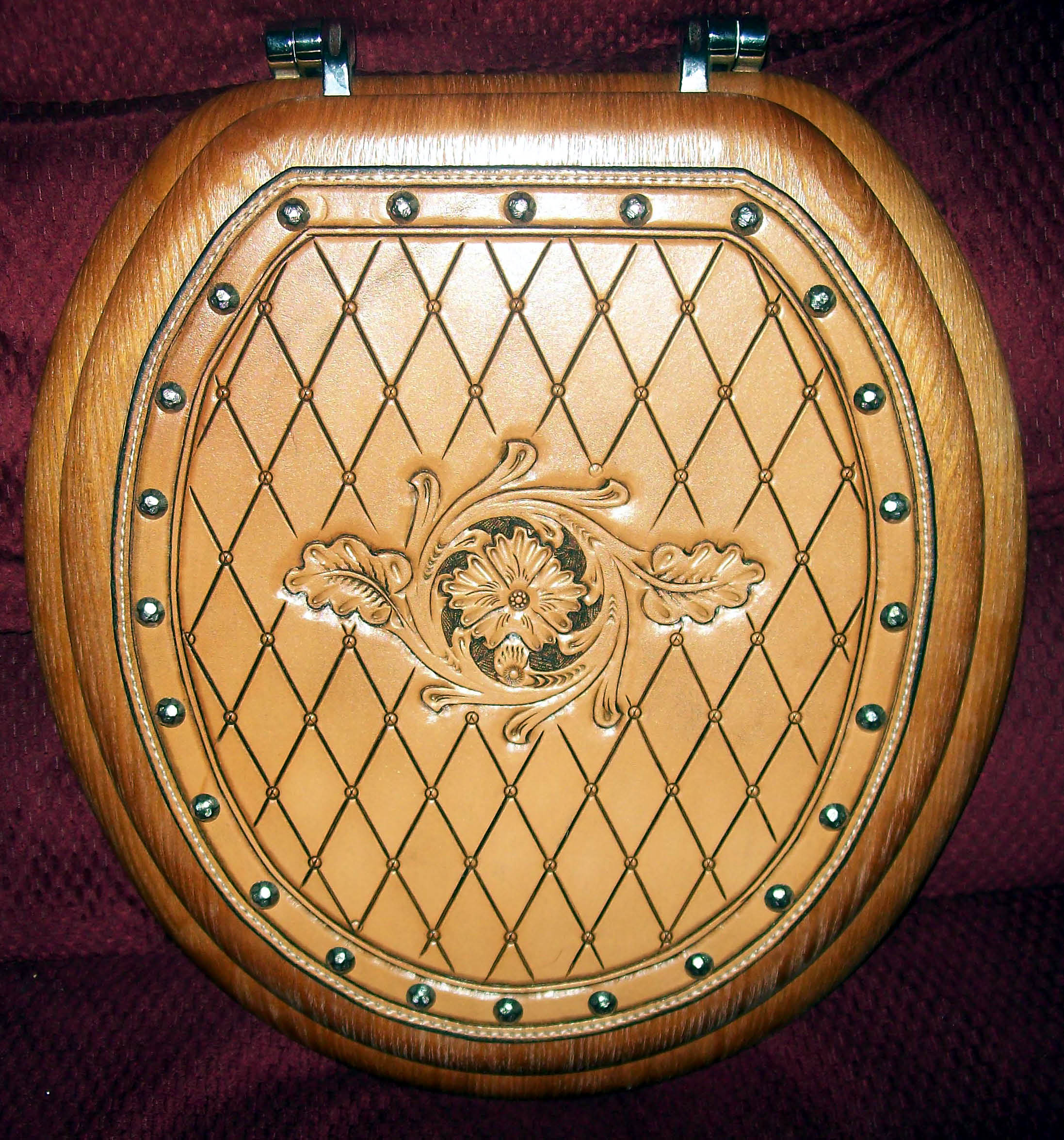

Members Double U Leather Posted August 28, 2009 Members Report Posted August 28, 2009 Here's a quick little toilet seat cover I made for the house. It turned out okay I guess. My Neatlac didn't go on evenly, so there's a bit of antique smudge on the upper left corner. Let me know what you think. Quote
Members MHolzer Posted August 28, 2009 Members Report Posted August 28, 2009 Here's a quick little toilet seat cover I made for the house. It turned out okay I guess. My Neatlac didn't go on evenly, so there's a bit of antique smudge on the upper left corner. Let me know what you think. I'd be proud to sit on that:spoton: Quote
dirtclod Posted August 28, 2009 Report Posted August 28, 2009 It really looks nice. Great job. You might want to adjust the tension on you sewing machine. It looks like it didn't pull real tight. Quote
Members Double U Leather Posted August 29, 2009 Author Members Report Posted August 29, 2009 Thanks for the comments guys. I appreciate it. Dirt.......I think it might be in the pic. In real life, the threads are tight and the stitches are uniform. Quote

Members Double U Leather Posted August 30, 2009 Author Members Report Posted August 30, 2009 Lindsay..........I think it's just Eco Flow antique. I'd have to go check to be sure, but it comes in a white squeeze bottle. It's kind of a liquid gel sorta rather than the Fiebing's paste. Other than that, it's just a typical Sheridan finish- Neatsfoot oil, Neatlac, antique, and then Tan Kote. Quote
