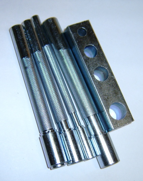

outcast Posted September 22, 2009 Report Posted September 22, 2009 I bought this spot setter to set spots with, but I'm not sure if I'm using it right. Can anyone tell me the correct way to use this thing? Quote Steve I am not of this world....set apart....an outcast. http://s233.photobucket.com/albums/ee215/outcastleatherworx/
Members Tkleather1 Posted September 22, 2009 Members Report Posted September 22, 2009 On 9/22/2009 at 7:03 PM, outcast said: I bought this spot setter to set spots with, but I'm not sure if I'm using it right. Can anyone tell me the correct way to use this thing? Well In theory you put the spot in the corect setter. The long one with the sliding part. Slide the sleeve over the spot, put the spot where you want and place the anvil under the leather and line up the correct dimple in the anvil directly under your spot. not smack the setter with a hammer or maul and TAAAADAAAAA you probably missed the anvil. Now how I use it is insert spot in setter, place leather over poundo board line up spot where you want and smack with maul. turn over the project and bend the tabs on the back of the spot with a screwdriver. and TAAA DAAAA you have a set spot. Tim Worley TK-Leather Quote Tim Worley TK-Leather If you don't ask and dont try how are you gonna learn anything?
Members TTcustom Posted October 10, 2009 Members Report Posted October 10, 2009 On 9/22/2009 at 8:35 PM, Tkleather1 said: Well In theory you put the spot in the corect setter. The long one with the sliding part. Slide the sleeve over the spot, put the spot where you want and place the anvil under the leather and line up the correct dimple in the anvil directly under your spot. not smack the setter with a hammer or maul and TAAAADAAAAA you probably missed the anvil. Now how I use it is insert spot in setter, place leather over poundo board line up spot where you want and smack with maul. turn over the project and bend the tabs on the back of the spot with a screwdriver. and TAAA DAAAA you have a set spot. Tim Worley TK-Leather This is exactly how I use the thing. The anvil/ prong clincher stays in the box now. Quote I am fifty years old and I have always lived in freedom; let me end my life free; when I am dead let this be said of me: 'He belonged to no school, to no institution, to no academy, least of all to any régime except the régime of liberty.' "What we need is more cowbell!"

Members thorr Posted October 10, 2009 Members Report Posted October 10, 2009 heres a tip. take a permanent marker and mark the centers of the pits on the side of the anvil. much easier to line them up that way Quote
Members Double U Leather Posted October 10, 2009 Members Report Posted October 10, 2009 I also whack the spots into a poundo board, or in my case, into a piece of rubber conveyor belt and then bend the prongs over. I have found though that sometimes the spots don't fit exactly right, and they bend the prongs and the spot sets sideways. Typically, it's when the spot is a tad smaller than the sleeve and it doesn't fit up in there snug. At that point, I go old school and use an blade awl to made the holes for the prongs. Quote
Members Tkleather1 Posted October 11, 2009 Members Report Posted October 11, 2009 On 10/10/2009 at 6:27 PM, thorr said: heres a tip. take a permanent marker and mark the centers of the pits on the side of the anvil. much easier to line them up that way that would work great if the project is the same width as the anvil. Quote Tim Worley TK-Leather If you don't ask and dont try how are you gonna learn anything?
