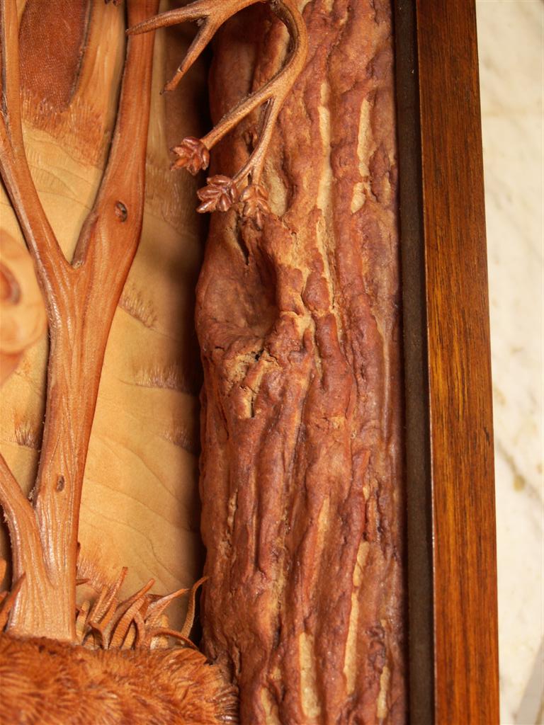

Contributing Member ClayB Posted October 7, 2009 Contributing Member Report Posted October 7, 2009 Leather dust is just that, ground up leather. It is made into putty by mixing it with rubber cement, or in some cases contact cement. The main use for it that I know of is to fill in the back of embossed leather carvings. Back when Al Stohlman was doing embossed pictures, he made leather sculpted plugs to put on the back and when these were tooled around, they made the leather stand out on the front, giving it a 3-D effect. Robb Barr is usually given credit for the "extreme embossed" technique that many people use today. I was told that he wasn't the first to use leather dust/ putty, but I don't remember who was supposed to have told Robb about it (maybe Kathleen Bond?) Robb made a series of videos with George Hurst showing several projects that he made using the extreme embossing technique. With his technique, the leather is stretched from the backside creating a cavity. This cavity is then filled in with the leather putty mixture. There are times when even more stretch is wanted, and to do that, some parts of the leather is cut through on the front of a carving. Then that cut out part can also be filled in with putty. When it's done right, it's really hard to tell where the leather ends, and the putty starts. The putty can be shaped and textured just like the original leather. Jan Schoonover is a master at that. There are also times when leather putty can be applied to leather for a different texture altogether. Adding fairly realistic bark can be added to trees is one example. These are the most common uses I know of for leather putty. There are probably others. I'll add a few pictures to show some of these techniques. Robb Barr Grizzly Jan Schoonover Grizzly Bark More bark Quote ClayB Badlands Leather Art blog Badlands Leather Art Website
