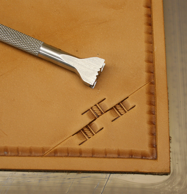

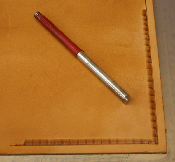

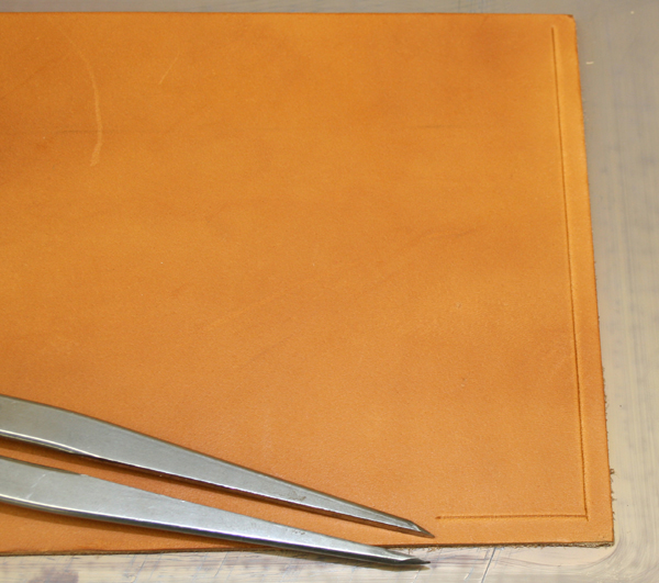

Members dbarleather Posted March 26, 2008 Members Report Posted March 26, 2008 (edited) Here the series of steps I do when basketweaving. Edited March 26, 2008 by dbarleather Quote http://www.dbarleather.com
Members dbarleather Posted March 26, 2008 Members Report Posted March 26, 2008 (edited) Looks like it puts the photos in any order it wants. I couldn't put all the photos in here (not sure why). Hopefully it explains alignment. Basketweave, when done correctly, is a time consuming way to tool. Let me know if you need more pics. I might try and post them later tonight. Edited March 26, 2008 by dbarleather Quote http://www.dbarleather.com
