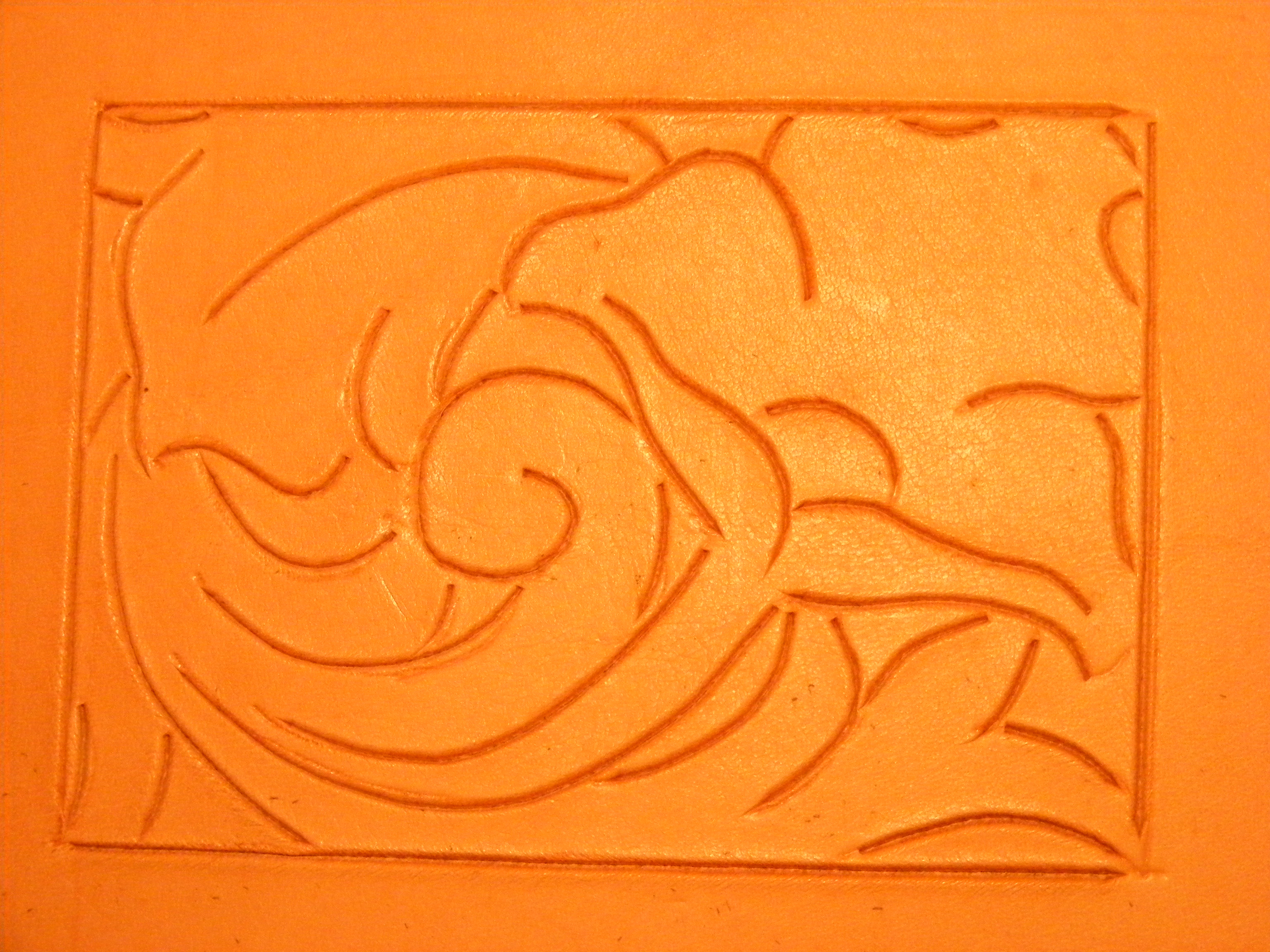

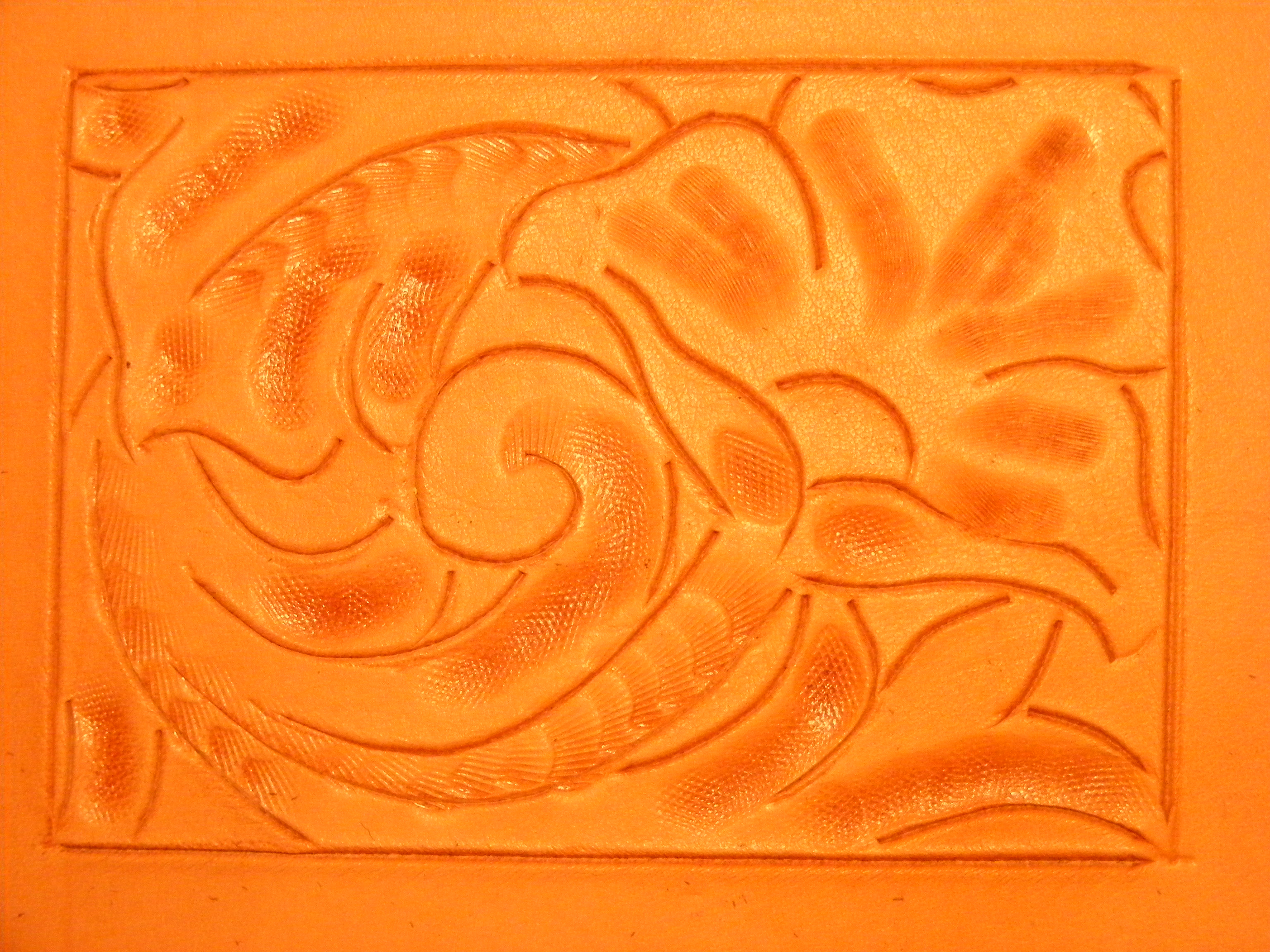

Ok here we go if I can figure out on how to post pictures. I quit on this one when I realized that I beveled on the wrong side of the stem.. :oops: But any way I took pictures of my swivel knife cuts and on through the beveling. Well half way through that lol.
Ok im going to have to do this in 3 different posts, I dont have a clue on how to resize pics.
Heres the cam
