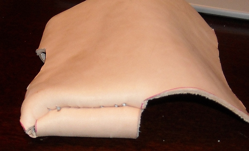

Thought I'd try a case for a new phone. (My now-dead phone was a flip-type that fit in my pocket.) So I came up with a simple design and built a prototype. The idea was to sew the seams and then reverse the whole thing. But when I flipped it inside out, the seams look terrible. I suspect I'm missing a step and thought I'd ask for some directions. Should I be creasing the seam first?

Texasjack. It's a bit hard to see what you mean without a pic but generally a seam will need to be "dressed". This means that you will need to rub them flat or if the leather is a bit thicker you can gently tap the seam with a hammer.

Another way is to put a corded welt in the seam which is used to hide the stitches (or cover-up a multitude of sins).

OK, found the camera. As you can see, I really roughed out a design on a piece of scrap leather. If you look at the seam after it was inverted, you can see how really, really bad it looks. True, I didn't spend a lot of time trying to get the seam really straight.
If I understand the earlier response, I need to wet and rub the seam very flat. Or use a corded welt. (Covering a multitude of sins sounds pretty attractive to me, BTW!) Or, go with a different design.
After going this far, I hate to give it up before I understand what I'm doing wrong.

You need to skive the seams back to get some of the bulk out to use that method. Thick leather doesn't fold very well as you have found out.

This would be my opinion, when you either punch holes or use your four,three,two,one chisels make your lines of stitching extremely straight, and when you sew make it hurt! what that is, sew with a lot of strength to keep it tight. Get it wet when stitching as well, it helps in the form/mold process. This is in no way critisizing your things, we all learn some way or another. The difficult way is where i went and actually have slowed down with the impatience, which is great for me to do
