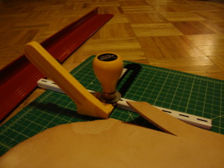

Hi frank207,
i had trouble with one of those tandy strap cutters as well, and had posted a topic in the "How do I do that?" section back in September. Celticleather told me to put a narrow strip of card (1/4" by 1/16") inside the handle on the cutting side. i tried it, but it didn't work on the tandy strap cutter i had.
So i experimented with an "Olfa" brand "CMP2" heavy duty circle cutter, (bought from cutting-mats.net $37.80; can be bought from other drafting, art, and hobby stores at lower prices)
started out using the pivot needle and then 2 small pieces of wood as a fence, but both methods produced an uneven cut. Then i read the topic "Tips/tricks For Cutting Straight Edge The Length Of Full Side?".
(see Frank's post in topic, quoted here).
Frank
Posted 16 November 2010 - 05:54 PM
I bought a 10' length of steel shelving channel ( U-shaped that gets screwed to the wall and brackets placed on to create instant shelves) for about $2.50 at any hardware store. The U-shape makes it very easy to press down and scribe a line without it sliding on the leather.
Thank's Frank!
We had redone the pantry, so i had some spare shelf standards/pilasters to use. Asked my Dad (He has more experience in cutting metal) to cut the shelf standard short and remove the sides from the middle of it to fit the circle cutter; filed the ends somewaht smooth; placed leather in the gaps between the standard and the circle cutter; and put the large washer on top of the standard to prevent bending.
To start the cut,clip the corner of the leather (The shelf standard tends to catch on the leather when starting the cut). Set the blade to just touching the cutting board or mat. Cuts smooth and evenly the rest of the way. Sometimes needs a second pass with a knife to finish the cut.
There are a few cons to using this thing:
1. The scale on the circle cutter is metric, so if you want inches, use a ruler; or with blade slightly exposed, place object of desired width between blade and shelf standard, and tighten the nut.
2. Limited cutting width (about 1 1/4" to about 5 5/8"; about 2.8cm to about 14.4cm)
3. Unless you cut part of the depth and finish with a knife, cutting boards or mats are required to protect work surface and blade.
4. Leather thickness is limited to thicker leather (i have only cut about 8 oz. with it thus far, so i don't know how thin it will go).
And that "Original" strap cutter sounds like it is worth a try, from what i've read in previous posts.
