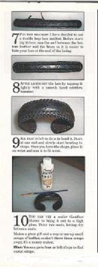

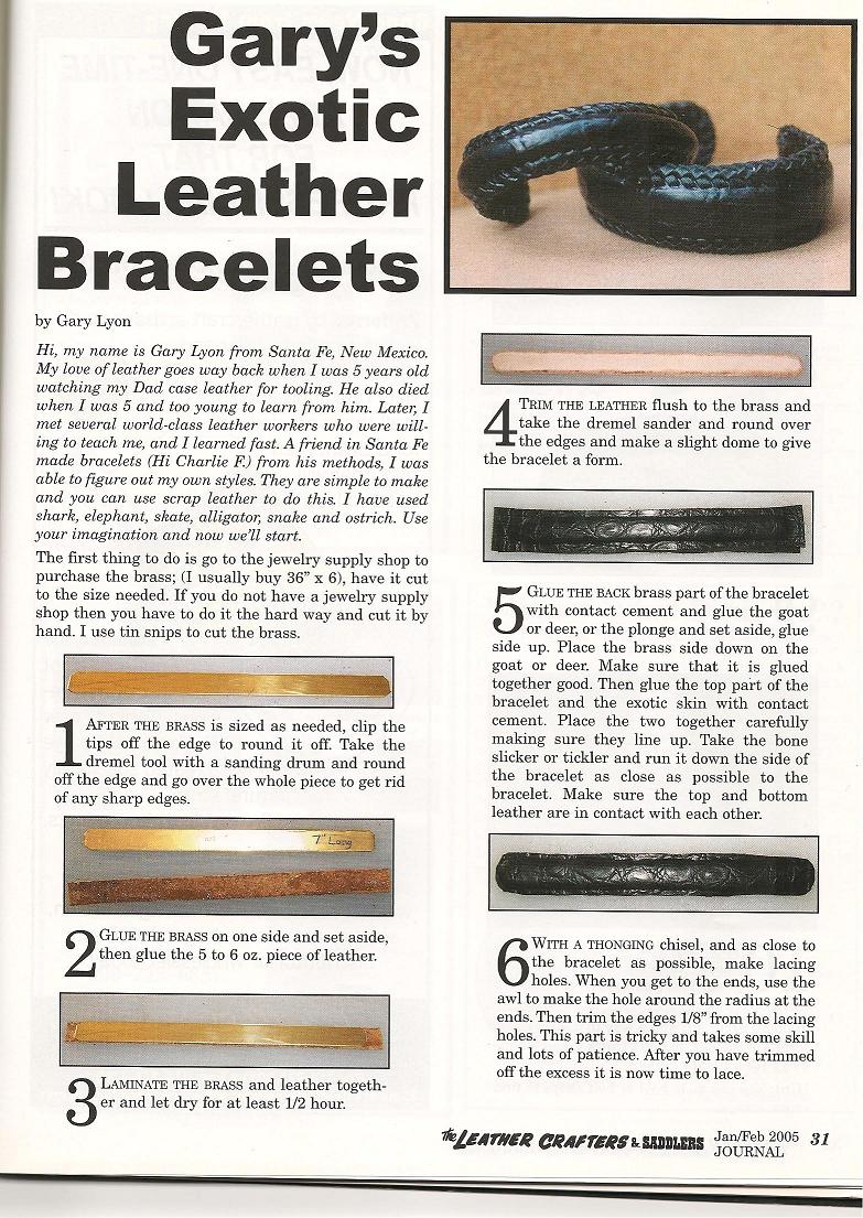

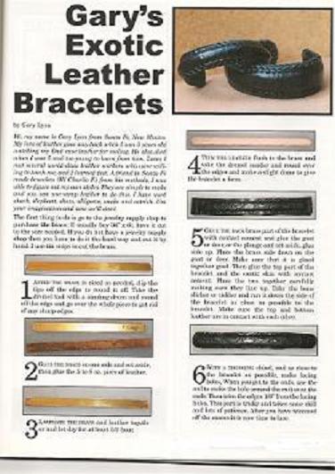

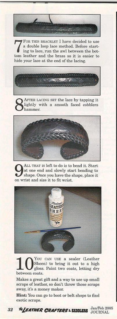

Well I got the hint. If you post a picture and let people know that I will show you how to do it they will come and they did .lol. So I decided to post the instructions .now you can get the instructions at leisure.enjoy the instructions and if you need more help please feel freee to contact me at:
leatherman1457@aol.com
keep in mind that the brass can be modified to make bracers or any shape of design your imagination can come up with. I have made some of these 3" wide and made pendants to match by cutting out the shape of the pendant out of 18 to 20 gage brass and soldering a bail on the back and them proceeding like the braclet. women like bracelets that are a little thinner so I use 1.4" for women and 3/8 " for men. 5 1/2 to 6 1/2" long for women wrist and 6 1/2 to 8' long for men.
Please use this set of photos . the others are blurry

Hi Gary,
Great tutorial and a nice idea. What ga. brass are you using for the 6" bracelet base/form?
Thanks in advance.\
Hi Gary,
Thanks in advance.\
I use 18 gauge brass that I purchase froma jewelry supply store. I have them cut them for me since they have a sheet metal cutter and they only charge me .10 a cut. I get one sheet cut which makes about 100 bracelets. I have them cut them to different legnths from 6" to 8" depending on if it is for a man or a women
If you have any more questions plese don hesitate to contact me and ask. Ask and I will answer. lol
