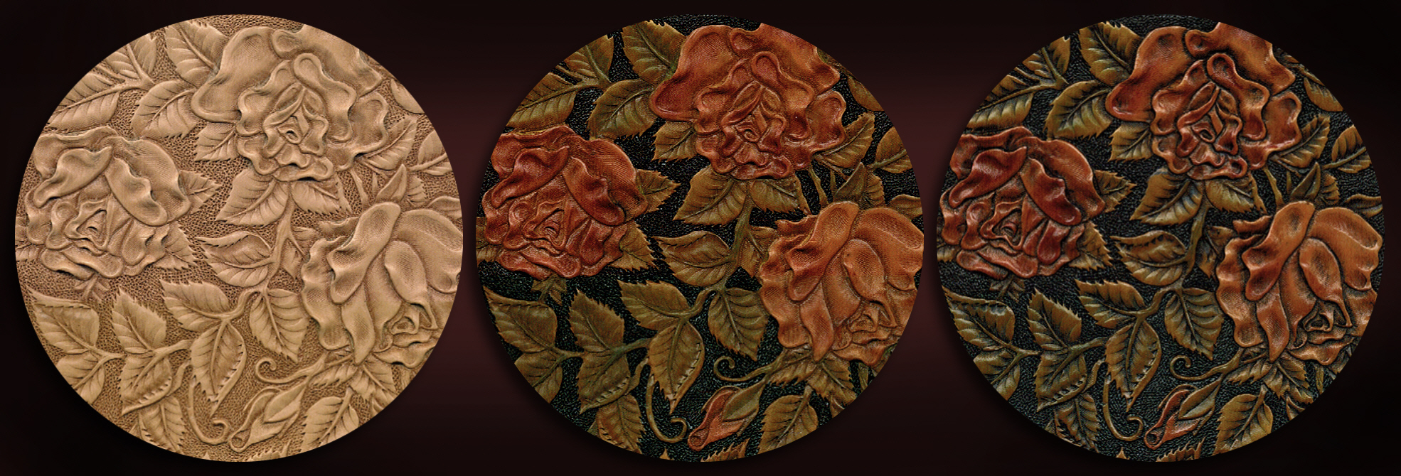

I might just give my 2 cents too as I love the Antiqing finish and use it on almost everything leather I make...
1. Due to only using spirit dye my leather needs a coat of pure neatfoot oil. I let it dry for 24-48 hours (I know it's hard but, just leave it alone *S*)
2. I apply 2 thinn coats of acryllic sealer (type satin/super sheen) and again...I leave it alone for another 24 hours.
3. Now it's time to get the antique on your work...After yet another day I seal the whole thing and Voila-Done! blahblahblah.gif
4. The picture shows about how it would look...
//Tina who has massive drawbacks and need some space SOON to do some leather workhead_hurts_kr.gif
