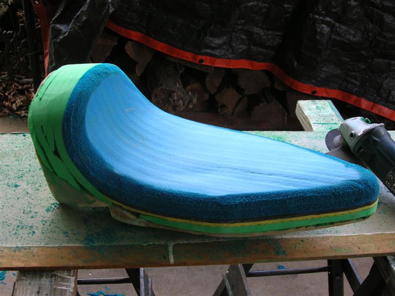

Members ChaChi Posted April 2, 2008 Members Report Posted April 2, 2008 Here's a factory seat I did a couple years ago. And here's a chopper seat I'm working on now that has a fiberglass pan. Notice the layers of different kinds of foam. The green in the flooring tiles like used for kids play areas and the blue is the yoga mat. Cover that in cotton batting after you have the shape you want and it's ready for leather. Quote I gotta have more cowbell !!!!
