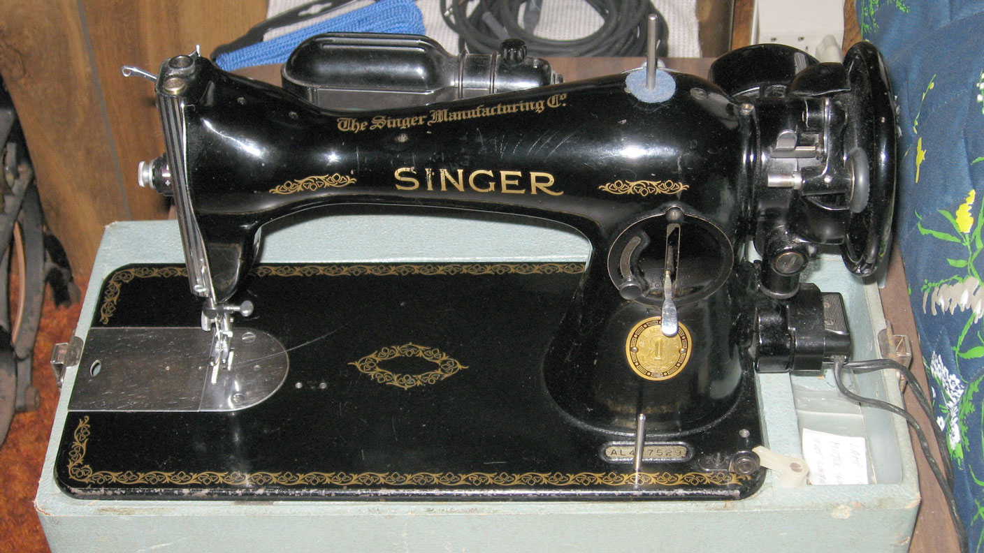

Moderator Wizcrafts Posted December 18, 2009 Moderator Report Posted December 18, 2009 (edited) Have a chance to buy a singer 201 fully serviced for 100 dollars. Im wondering if this will work for sewing leather holsters ect. arthtitus in my hands kills when I handstich. I meant to reply to this regarding the machine you were considering, but got carried away with the why-nots. I have a Singer 15-91, which is almost identical to a 201, in that they both use the same, built-in motor and gearing system. The only real difference I can see is the placement of the take-up and tensioning parts and thread guides. Since my 15-91 is virtually the same machine I can give you some insight into what it can and cannot sew. Here are some things I have learned about the capabilities of these machines. The maximum thickness under the pressor foot is no greater than 5/16", with the tension engaged. The foot can be lifted higher to remove or position the work, but it will not stitch reliably beyond that thickness. The machines use home sewing needles, which are usually limited to a maximum size of #18. I did find and buy some #20 needles for the 15-91, but they are rare. The thickest thread it can deal with is #69 bonded nylon. I had to reduce the bobbin tension way down to get the knots up into two layers of 8-9 oz belt leather, without over-tightening the top tension disk. Over-tightening the top tension disks causes the poor machine to bog down as it tries to pull up the thread. This stresses out the take-up arm, to the point I was concerned it might warp or break off. The little motor that is built into the body bogs down when trying to penetrate two layers of carving leather. I had to hand wheel a few stitches to get the motor to kick in and take over. The motor gets hot as it is forced to sew into leather. It finally smoked and I had to replace it, costing me 50 bucks for a rebuilt motor. It took a lot of time and some heavy screwdrivers and lots of hand pressure to disassemble the machine's read end to replace the motor. These machines are very old and have old wiring that tends to break when you dink with it. I have to rewire the power block on the back after replacing the motor. I had to screw the pressor foot tension spring all the way down to keep the leather from lifting up, when the needle came back up to form stitches. If the leather raised up with the foot, there were skipped stitches. The Singer 15- and 201- machines only use feed dogs to advance the material. With the pressor foot tightened all the way down it causes drag on the top layer of leather, or whatever material in being sewn. This drag causes alignment errors between layers and the stitches will vary in length. There is only 7" of clearance between the needle and the bottom of the body (on a 15-91). This makes it difficult to rotate thick leather as it is sewn around turns and shapes reaching that size. A pancake holster may well have a side that is over 7 inches long. There is about 2" additional clearance that tapers above the inside base. If you can fold the material up into that area you will be able to sew wider projects. If it is too heavy to fold up you will be limited to 7" inside the needlebar. Here is a photo of a Singer 15-91, which is similar to a 201 model: With these limitations in mind you should be able to make a more educated decision about what type of sewing machine to look for. Call Bob Kovar at Toledo Industrial Sewing Machines (Toledo, Ohio), at 866-362-7397, and ask what he has in the warehouse that will fit your needs. I am sure he has used machines that will get you going, at a price that a member of the human race can afford. Edited December 18, 2009 by Wizcrafts Quote Posted IMHO, by Wiz My current crop of sewing machines: Cowboy CB4500, Singer 107w3, Singer 139w109, Singer 168G101, Singer 29k71, Singer 31-15, Singer 111w103, Singer 211G156, Adler 30-7 on power stand, Fortuna power skiver and a Pfaff 4 thread 2 needle serger.
