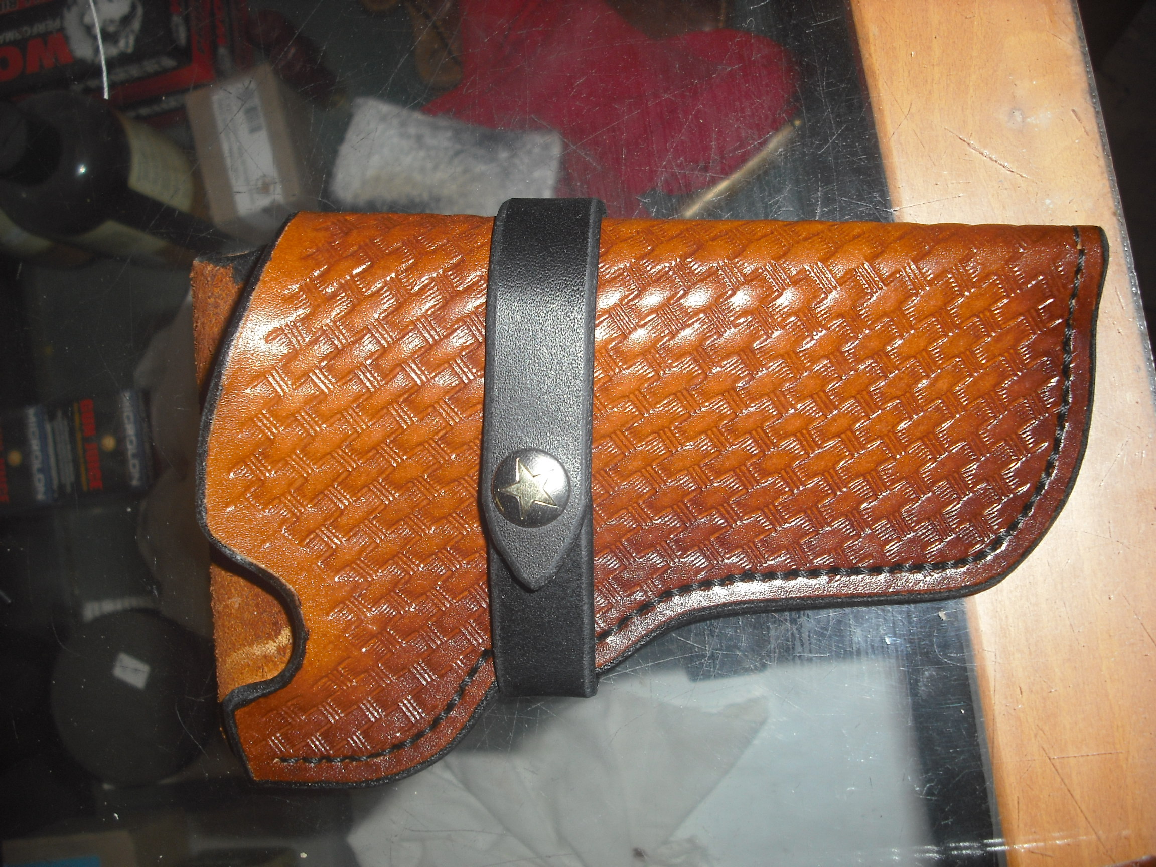

Below is a link to a holster site. It should show a holster set with a "sunset" finish. I am interested in making something like this and would like some input from experienced people on the best way to approach this type of finish. I am assuming the light area is simply a clearcoat but how do they get it from black to light brown with the light speckling. This is probably a really dumb question but after construction do you apply neatsfoot oil before using an oil based dye? What is the process step by step for using deglazer, oil based dye, neatsfoot, and resolene? If you can help please spare me a couple minutes of your time.

Ok, so you dip the edges of the holster in neatsfoot oil, correct? Or do you dip the edges in the oil based dye? I know I am making this harder than it probably really is but I dont like to create waste. I have used neatsfoot oil on some of my stuff and have a hard time getting it to darken the leather, I didn't know you could mix the neatsfoot with the dye, that is a pretty good idea to try.

Ok, I just finished a holster and will post the pics on here probably tomorrow. But have you ever had any problems with resolene leaving bubbles or have a hard time getting an even finish witout it running? I have worked out my issues with the oil dyes but but the actual "clearcoat" is a different story. I have used resolene on about 6 different items and it wants to run or leave bubbles when applied with rag, sponge, or spray.
I do greatly appreciate the feedback. Also what brand of basketweave tool leaves the most detailed or defined pattern? I used a tandy cheap one and when I folded over the holster it kinda stretched out the pattern and made it look faded.
