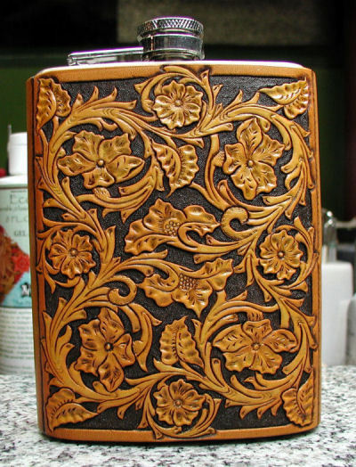

I wet form. Leave your back side a little longer than you think you will need, it will shrink a tad after drying. I usually wrap the piece with another piece of leather and rubber band it to the flask. Set the front side down on a shooters bag (don't tell hubby) then place a plastic coffee can filled with marbles on the concave part of the back and let dry. This will get you your shape. Trim the back edges to fit after drying. I haven't glued any to the flask itself, but I do use a piece of double stick tape on the seam (after lacing or sewing) to help it hold it's shape to the flask.
I have also made a leather boot for the bottom and riveted to the main body that had straps on the top to make it completely removable. I do this with the 64 oz flasks.

I never wet form any of my flasks. I will tool them and finish them before I assemble. I will glue the leather piece to the flask and then stitch closed using a simple baseball stitch. Then a couple dabs of glue to hold the back down. I use another flask with a clamp to keep the back pressed down till the glue dries. For the glue, I use a product called Black Max from loctite. It is a rubberized superglue. Hope this helps.

I've only made one (the one in my avatar) and did not wet form it. But I also used upholstery leather for the main covering with the decorated piece of tooling leather sewn onto that. I like the color contrast. The heavy leather cut-to-shape pieces on top and bottom made sure the covering was in the right shape too.
I did it all with lacing. I generally prefer lacing to stitching, so haven't gotten into stitching yet.
