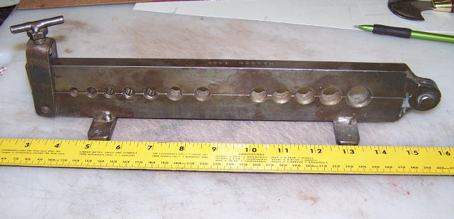

What is a rein rounder and where might I find one.
A rein rounder is a device, usually a plate with consecutively smaller holes, through which a strap is drawn to make it round. Since you're gonna use them for cores, you might try using a board with some holes bored in it. Smooth it with sand paper, add saddle soap, and start rounding.

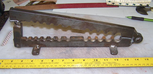

Here's a picture of mine. Theirs not to much to them. I put mine in a vice when i use it. Weaver Leather has them. Or you can make one. rounder 1.JPG rounder 2.JPG
dirtclod - that looks a lot like a tubing flare jig. I wonder if you could find one at one of the discount tool houses (Harbor Freight, Homeier, etc.) cheep? wonder if it would work? Just pondering, no need to respond.
Howard i tried the tubing flare and it didn't work very good. I can't remember why it didn't work to good. I made one out of some hardwood and it worked better than the tubing flare. Then a guy came by my shop and he the metal one and i bought it. It works a thousand times better than either one of the others.
can you tell us why the wood dint work id like to know why thanks
It's been at least 10 years ago that i tried the wood and i can't really remember why it didn't work as well as the steel one. But i do know the steel one works the best. You can make one out of wood and try it for yourself. Maybe you will have better luck than i did.
