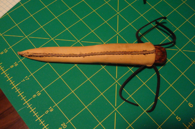

Here is my first attempt at a Scandinavian style knife sheath (my first knife sheath ever actually) and my first attempt at the European technique called "pauting". This style of sheath is a bit different than 'western style' sheaths in a couple of areas. First, the leather used is a special type called rautang (spelled slightly different with special characters) which is a type of half-tanned leather made in Sweden, Spain and Germany. Second, the seam isn't highlighted or prominent like ours as it is very small and hidden down the back side of the project. Lastly, and this has part to do with the construction technique, the sheath is wetformed around the entire body of the knife to to point that during the construction it can become difficult to initially release the knife from the drying sheath.
Pauting is a centuries old technique of working the leather (specifically half-tanned) after the sheath if formed. The special leather allows the worker to move the mass around using molding tools & modelers to create ridges and from those ridges, the details are fleshed out (pardon the pun). No cutting and no mauls/hammers or stamps are used even in the very nice sheaths.
Long explanation to show my simple first attempt. I had to relearn a few things as the techniques are slightly different from what we do here in the US but hopefully with more practice it will start to work out better as I really like the technique.
I made this for my Dad for his neck knife he uses for blackpowder patch cutting, etc.:

Where did you find your information on the Scandinavian sheaths? I'm familiar with sheaths of this type from medieval reenactment since this is how the vast majority of medieval knife sheaths were made, often with two layers of leather flesh-side to flesh-side or with a wooden core for bigger knives (and swords).

There are a number of websites about Puuko knives and the sheaths for them, the problem is that most of them are in Danish & Swedish and have to be translated. A google search for Scandinavian knives brought up the first bit of info and then I started to find suppliers and professional blade makers websites that led me to the more specific articles like the one I referenced above.
