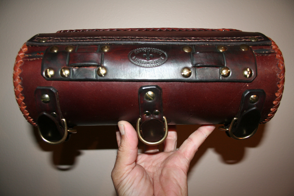

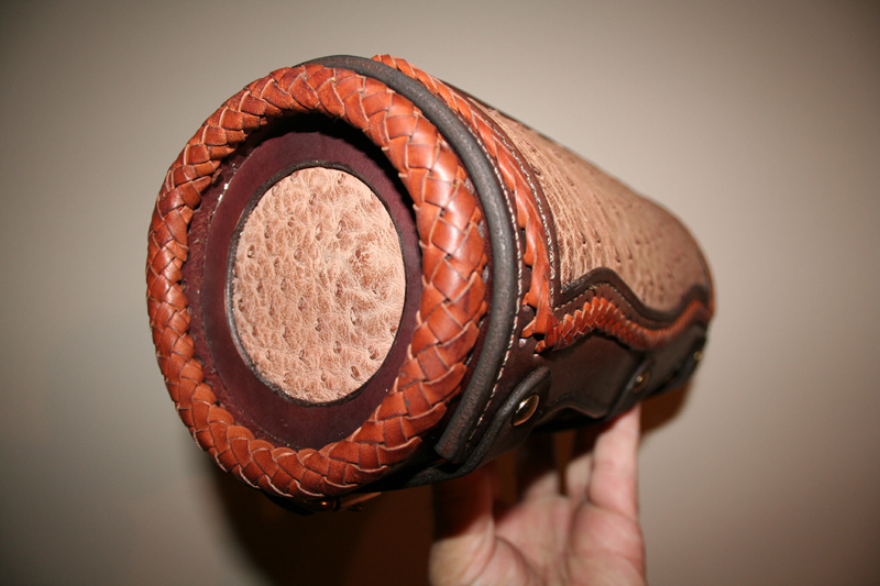

What I do is use a piece of 4 inch PVC pipe about 3 inches high with the top edge beveled to the inside, then I use a wooden disk that will fit inside of the pipe with enough clearance for whatever weight of leather im using for the endcaps, I wet the leather, lay it on the pipe, set the disk on top and tap it dowm the pipe until it bottoms out against a flat surface this has been working for me and its pretty simple

Thanks Syd, heres a couple more pics of it, just worked on it in between other projects so never really kept accurate time on it
