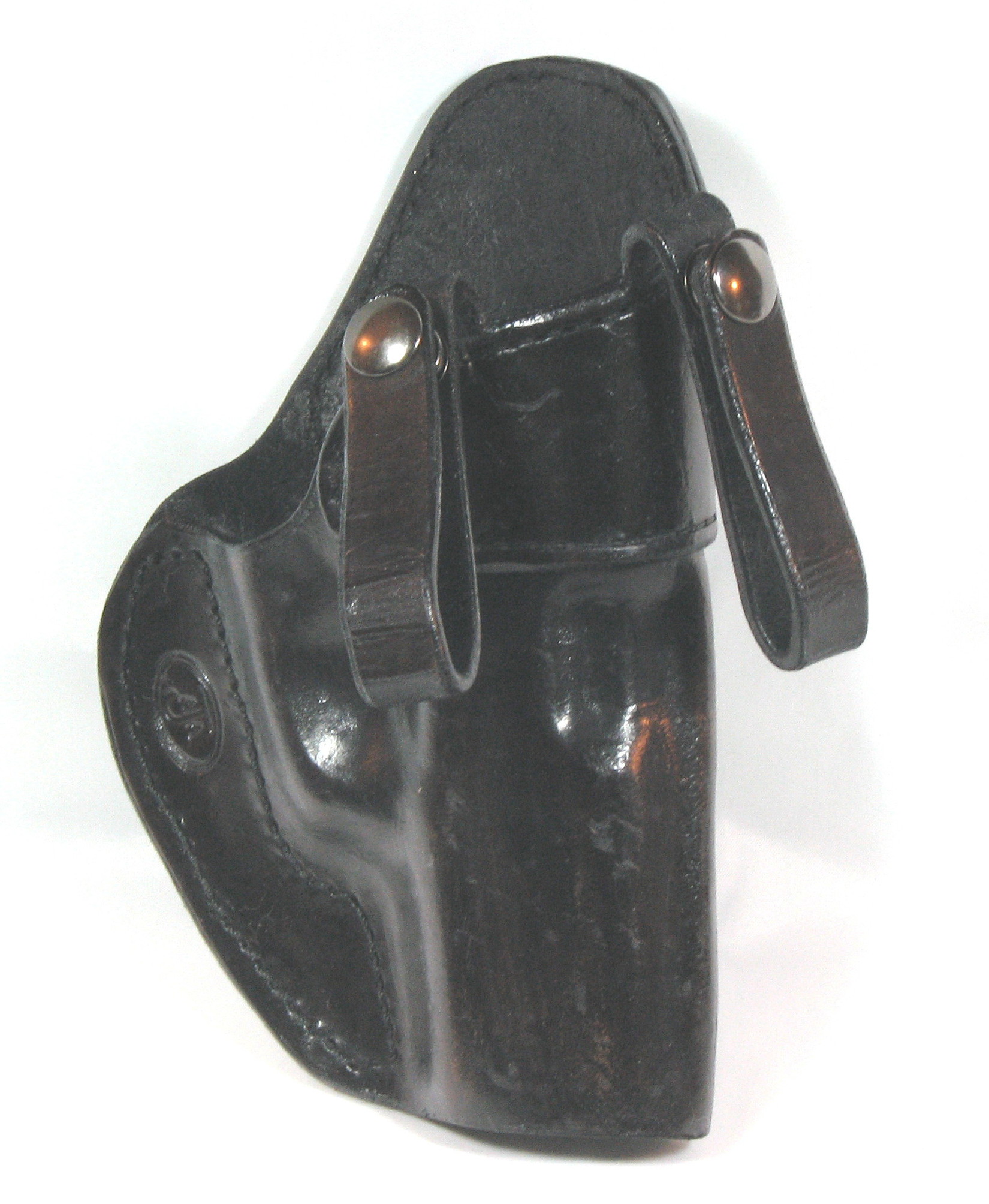

Here's a holster that I just finisher for a friend. You can see what Broomstick was saying about strap placement.
