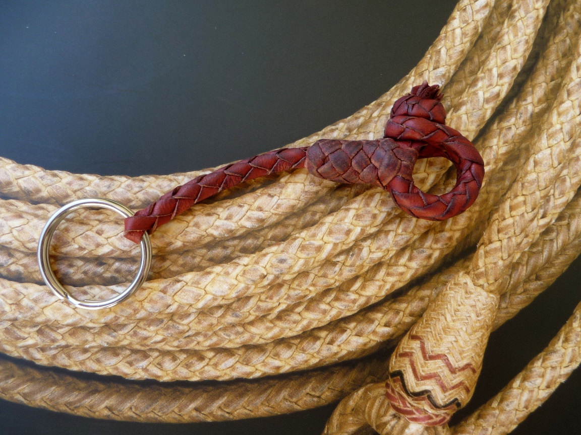

Members megabit Posted September 27, 2010 Members Report Posted September 27, 2010 Do yo mean a honda / hondo like this? IMG_3369 by ss1442, on Flickr Quote

Members CharlieR Posted October 3, 2010 Author Members Report Posted October 3, 2010 Thanks guys, but a rope knot is n't a honda--it's basically a braided knot made of rawhide that holds the rope to the horn--used when dallyin'. Quote
