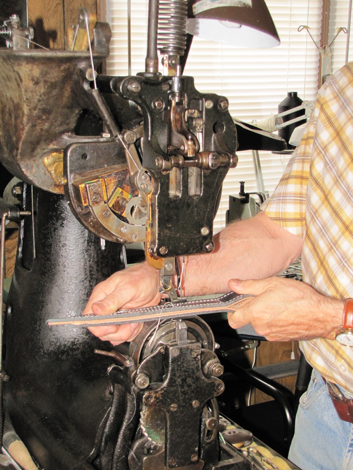

I need your opinion about this great sewing machine, i need know if will be suitable for the type of work I perform.
It is a very big money for my pocket and I must make sure I do.
My work will be luggage, briefcases, suitcases, bags, purses, wallets, holsters, etc.
Before meeting you I thought that all the sewing machines stitching in the same way. Now i know i was wrong.
This photo attached by a partner is very enlightening...
I wish I had the best machine possible and make the best stitch.
Within certain limits, no matter the money's worth.
I must admit I've fallen in love with Campbell.
Has a lot of positive things for me:
has recognized, is 120 years old and I love antiques, makes a perfect stitch...etc
There is, however, one question i have no clear... can you work comfortably with small leather goods like wallets and similar?
I saw a video in youtube where you can see sew a camera case to a very low speed and with absolute control over the seam.
Can you do the same with Campbell?
As I said before I want the best, is Campbell for me?
If not, which?
Thanks very much for your attencion and for your patience with my bad english.

Do not know a thing about the machines you are asking about. Just needed to tell you, "Your English is fine, just wish some of the (Residents ???) of the USA could speak as well."
ferg
Yes, you can sew a camera case like that on a Campbell Randall needle and awl machine. You cannot mechanically sew in reverse with them, but, if you are careful, you can spin the work around and sew back through previously stitched holes. The needles have a barb near the top. The top thread is looped into the barb, then pulled down and around the bobbin, to form a lockstitch. The barbed needles tend to rip out previous stitches, unless you carefully position the barb to just miss the other stitches. Tricky, but I do it all the time on my Union Lockstitch machine.
Aside from the difference between types of needle, the main difference between the machine in your embedded video and a Campbell stitcher is the motor and drive system. The leather machines being built and sold today are using servo motors and often, speed reducers, to allow the precise control of the machine in the video. Furthermore, that motor has a needle position control, which allows you to use your heel to stop with the needle down. This is a no-brainer with those electronic positioners.
A needle and awls machine uses a constantly running motor that drives a belt that goes around a huge flywheel, which free-wheels on the back of the main shaft. When you turn on the motor, the flywheel spins, but does not engage the machine's mechanism. Only when you press down on the big drive pedal, does a lever push the flywheel into a circular clutch pad on the back to the main shaft of the machine. If you lightly engage (feather) the clutch, you can sew at very slow speeds. If you go all the way down you will sew at the maximum speed set by the ratio between the motor pulley and the flywheel diameter. On a Campbell machine the maximum stitching speed is usually set to about 300 per minute (5/second). This can be slowed down even more, with an optional, 2-speed - speed reducer assembly, to a bit over 2 stitches per second (125/minute), at full throttle.
I have sewn on a Randall and found it very easy to "feather" the clutch, for sewing one stitch at a time, without giving up the higher top speed, which some speed reducers force on you. There is a learning curve and you will go through a lot of thread and leather, but in the end you will be able to sew anything that fits under the pressor foot, including briefcases and some luggage. You limit is on the right side of the needle, where the body begins about 10.5 inches from the needle and awl.
Campbell Randall stitchers and use either bonded Nylon, bonded polyester, or left twist linen thread - run through Lax Wax in a wax pot (one on top; one for bobbins). The awls must be larger than the needle being used. A smaller number needle is for smaller gauge thread. A number 2 needle is equivalent to a #180 standard needle and is used with #277 bonded, or 5 cord linen thread. I use a number 2.5 awl with a #2 needle.
If you search on YouTube, you will find videos posted by the Campbell-Bosworth Company, showing their standard (for 3/4 inch sewing) and high lift (1 1/8") machines in action. Most people do just fine with the standard lift machines.
Something else you must know is that the example of stitching looks to intentionally favor the Campbell.
The turn in the stitch was NOT done correctly with the Artisan machine. Performed correctly, the walking foot machines will NOT leave the marks on the leather that are shown.
No other type sewing machine will match the stitching of a 'needle and awl' machine, but the 'unison feed / triple feed' machines can still produce a MUCH nicer stitch than what is shown.
I agree that the Artisan can do better, but the Campbell stitch would look better if the awl was twisted instead of straight.

The Campbell machine is manufactured by my family's company. It is the oldest machine of its type still made today and it has lasted through the years due to its durability and stitch quality . The machines we sell are factory rebuilt. We manufacture all the internal parts, and we remachine the casting of existing machines to original specifications. A rebuilt machine will be perform like new.
Stitch Quality
What sets the Campbell apart, and the reason why it has not been replaced after 125+ years is the stitch quality. The Campbell was engineered to sew leather, and it replicates the process of hand sewing by first punching a hole and then making the stitch with a hooked needle. The needle and awl design makes a smaller and smoother hole than a single needle machine. Single needle machines were first designed to sew fabrics and webbing, and they are adapted to sew leather. If you compare the size and shape of a threaded needle compared to a Campbell, it is easy to see why.
The stitch quality on the bottom is also comparable to the top of the material. When sewing harder leathers on a single needle machine, it is common to see pucker marks on the bottom from the pressure of cutting the hole and threading in one pass. Softer leathers will cover this up better, but there can be a noticeably difference on the under side.
The Campbell feeds the material with the awl, and uses one presser foot. The presser foot is more adaptable to sewing closer to hardware and edges than walking foot machines that use two feet.
The tensions on a Campbell pull tighter than walking foot machines. The Campbell uses a systems of brakes that lock the thread while walking foot machines use springs and disks for tension. The brake system will pull tighter, enough to bury the thread into the leather.
The sample in your picture could have been made better, but if you compare the stitch of the two types of machine on the same leather, you will see a difference. For some the difference is not important and they prefer using a single needle machine which is easier to operate and cheaper. For those that want their sewing to be noticeably different, and quality is more important than price, the Campbell is best option.
Control of the Machine
We currently sell the machines with a custom table equipped with a clutch motor and pulley speed reduction system. You can select the speed by changing between 3 different pulley sizes. We had experimented with the servo motors commonly used today with other machines, but we were not satisfied with the power they produced. A machine like the Campbell weighs about 200lbs (head only), and the servo motor dose not produce as much torque at slow speeds at a clutch motor. For that reason we continue to use the clutch motor, although we are open to change if a better system can be developed. The design of the current motor table allows the operator to “feather” the clutch much like the clutch on a car with a manual transmission, and it is possible to run the machine one stitch at a time without touching the hand wheel.
We cannot compete with the cost of machines made in China, but our machine is close to the cost of name brand machines like the Adler 205-370 and the Juki TSC-441. We manufacture the machine in the USA, including all the parts. Since this is a specialized machine, we do not sell hundreds like other brands that can be adapted to applications besides leather, so our costs will be more. The quality however will be hard to match when compared to other machines.
If you would like, we can supply sample sewn on our leather or yours.

It really seems harder to handle than new machines with servo but I think worth the effort to learn to manage it properly.
I definitely think it will be my machine.
