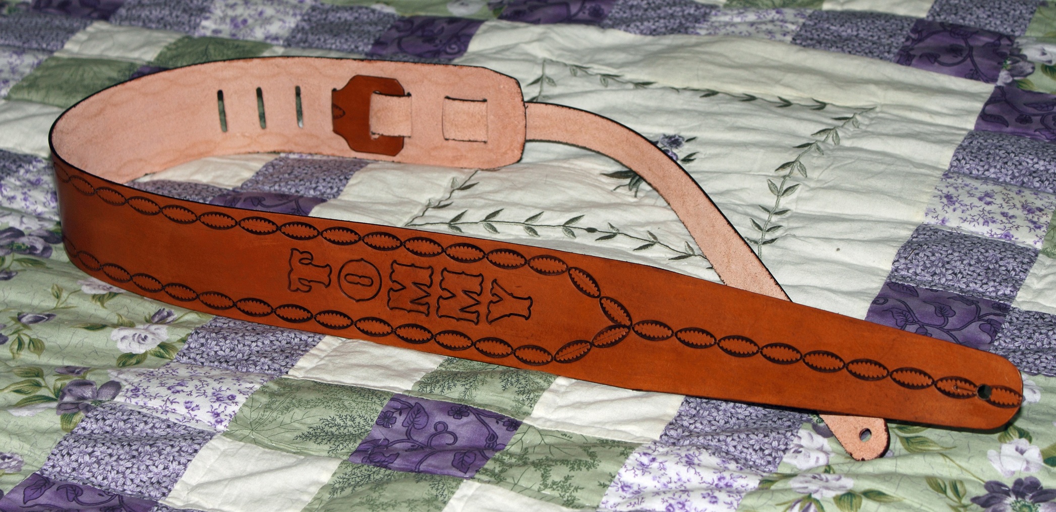

Members BDAZ Posted February 27, 2014 Members Report Posted February 27, 2014 (edited) So I don't get it! If you are making custom straps make a custom strap!! I think this patters is just ugly and I wouldn't put anything like it on my guitar. What I do is find the exact measurement of the current strap from point to point. If there are two buttons, then I make it as attached. If it is going to the peghead, then I will make a small strap that will fit under the strings and stitch a buckle on the other end or just use a latigo lace. I usually add the first name on the front of the strap and the full name on the back. so I also get the measurement of where the strap crosses the shoulder. I do have a number of attachment options on both ends the button to button style which will give a few inches of adjustment either way without the ugly woven widget. (See pic) I make mostly banjo straps and have started making guitar straps on commission. Custom is custom! Why compete with The Guitar Center? Cya! Bob Edited February 27, 2014 by BDAZ Quote
