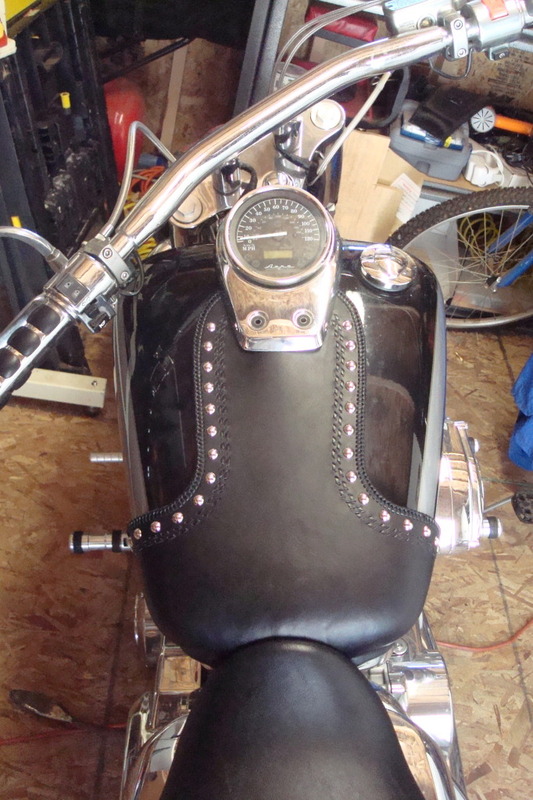

Here are the latest 2 bibs I have made for a custom request from a couple of gents in England.
5/6oz W & C leather, decorative double buckstitch and triple loop laced edges with 12mm domed rivets running between. At total of 23 yards of 1/8" kangaroo lace and 30 rivets on each one.

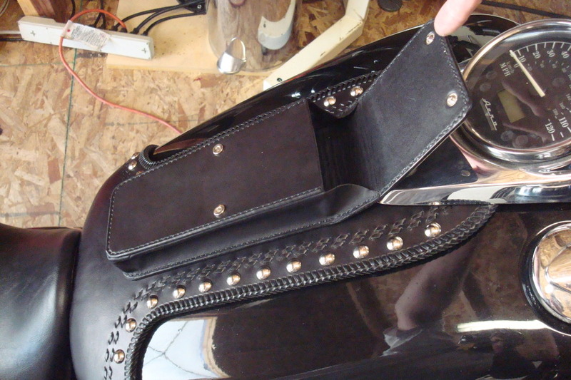

The pocket was a new design for me, moisture is a big concern over there so I designed the pocket to have no 'gutters' for water to sit in, all seams are either covered or downward facing and the lid has long gussets to ensure water stays out. When I asked how often they rode in the rain, their response was, "if we didn't ride in the rain, we'd never ride!" One of the guys wanted a pocket, the other wanted just the bib itself. They also chose different wrap styles.
Finish is a bit more hardcore than usual because of this. After dying & burnishing, I used neatsfoot oil, then tan-kote, then Pecard's leather conditioner followed by Pecard weatherproof leather dressing (2 good coats of the last).
Enjoy!
Chris
P.S. - you might notice some bowing on the wider bib in the photos. This is because I didn't want to bolt down the speedometer and possibly put scratches in the bib before it was centered and attached with the velcro underneath.
Once the owner mounts it on his bike, bolting everything down won't be an issue and there won't be any bowing.

Nice work Spinner. I really like the way you carried the gusset up on to the top to make it watertight when the top is closed.
