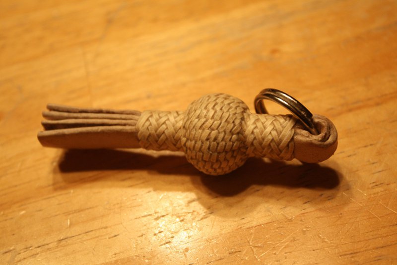

Members KnotHead Posted January 4, 2011 Members Report Posted January 4, 2011 Hi all. I know that Enrique Capone prepares his own deer rawhide and has made a few projects with it. He's on Face Book here is his profile if you would like to get in touch with him. He's a very nice guy to talk to. He live in Texas. Enrique Capone - FB Profile Link Here a photo of the key fob he made with his deer raw hide. Maybe he might be able to help you out. B... Quote
Members Handwerker Posted January 4, 2011 Members Report Posted January 4, 2011 Hi all, looks verry good !!! ....is that 1 Knot or a second one over the first Arno Quote
Members KnotHead Posted January 4, 2011 Members Report Posted January 4, 2011 It actually looks like it's all one knot Arno. But to be sure you should ask Enrique. Brian... Quote
Members troy Posted January 4, 2011 Members Report Posted January 4, 2011 well learn something new every day - uptil now I thought rawhide from all hides stretched like deer - as it was the only readily avaliable from my parts its all I have used apart from a couple of cows for ropes but even they stretched slightly (due I think mostly to being coreless). So ye, I guess it does stretch and I tried to over come this as best I could by allowing it to dry quite a bit until it was a sort semi cardboard consistancy before tightening a braid such as below; but as can be seem from this; the stretch factor does deteriate the whole effect slightly. Usually I use or did use rawhide for its strink characteristics once tied and I do tend to tie my knot tight altho I did find that dyeing the hide with veg dyes like black oak did slightly stiffen the hide as a whole up a bit - I used to treat my hides like buckskin as well by soaking it in a kind of brain mixture and hand stretching for a bit but this was only to create a softer appearance and obviously made the stretch problem worse by loosing up the fibres even more. In the end black hammer, like you I had a ready supply of the hides and it cost alot less to make my own then buy. Of course if you freese the hide when de-haired and still wet, then de-frosed and stretch, this did tend to stiffen it a bit - Refs de-hairing, after about my third hide I used ash from my fire in a big waste bin (instead of the chemicals which were not avaliable near to me)and soak the hides in that for about a week or less in hot weather (not a often occurance here)stirring around about twice a day to ensure all the hide got covered - found the neck hair the worse to remove where the skin is thickest and sometimes I would cut this off rather then wait a few more days when the hide might of gone off (your know by the smell - its terrible). Another thing that might help with keeping with inproving the stiffness of deer rawhide is to leave the thin whitish layer of skin on on the hair side - usually this is kept on for making buckskin which gives it that textured appearance - I have never tried it but it might help. so are you all telling me that horse hide does not strink even when damp? Quote
Members ifoo Posted January 4, 2011 Members Report Posted January 4, 2011 (edited) Hi all, looks verry good !!! ....is that 1 Knot or a second one over the first Arno I think that more than two knots, but some of them not visible. I also know Enrique Capone from another forum. I can say that it is a great guy who is always ready to help. Edited January 4, 2011 by ifoo Quote
Members lilpep Posted January 5, 2011 Members Report Posted January 5, 2011 just my two cents about Enrique's knot, it is what argentines call "bomba carcelera" it is a ring knot foundation and a the outer part is a "wrapping" with one more lace. the outer wrapping is a sort of hitching i myself haven't made one but here is a link to where you can find a few pics of the way it is made http://www.armasblancas.com.ar/foros/el-taller-de-soguero/19761-ver-si-me-echan-una-mano.html its in spanish but a couple of posts down the thread are the pics from an argentine book that the moderator of that subforum posted. Quote
Members miguelm Posted January 5, 2011 Members Report Posted January 5, 2011 just my two cents about Enrique's knot, it is what argentines call "bomba carcelera" it is a ring knot foundation and a the outer part is a "wrapping" with one more lace. the outer wrapping is a sort of hitching i myself haven't made one but here is a link to where you can find a few pics of the way it is made http://www.armasblan...n-una-mano.html its in spanish but a couple of posts down the thread are the pics from an argentine book that the moderator of that subforum posted. Gracias Jorge, tus aportes en A.B son muy apreciados. Acaba de salir a la venta la sexta edicion del Faudone " el arte gaucho....", los ejemplares se le pueden encargar directamente a Maria, su sobrina en: http://www.elartegau...do.blogspot.com un saludo. Thanks Jorge, your contributions are greatly appreciated AB. Just on sale Faudone the sixth edition of "gaucho art ....", copies you can order directly to Maria, his niece:http://www.elartegau...do.blogspot.com a greeting. Google translation added by Denise Quote
