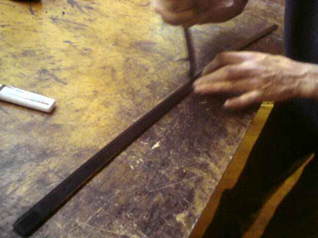

All the leather parts are now prepared. Time for some 'smartening up'. Here, the screw-crease is being heated with the gas canister, to make a nice smart crease along the edges of the leather. This not only gives a nice 'finished' appearance, but marks where the stitching will go too.
post-17557-044616700 1291135375_thumb.jp
Here, Paul is using the screw-crease. It has to be used quite firmly and quickly, to give a nice clear 'crease'.
post-17557-063317200 1291135386_thumb.jp

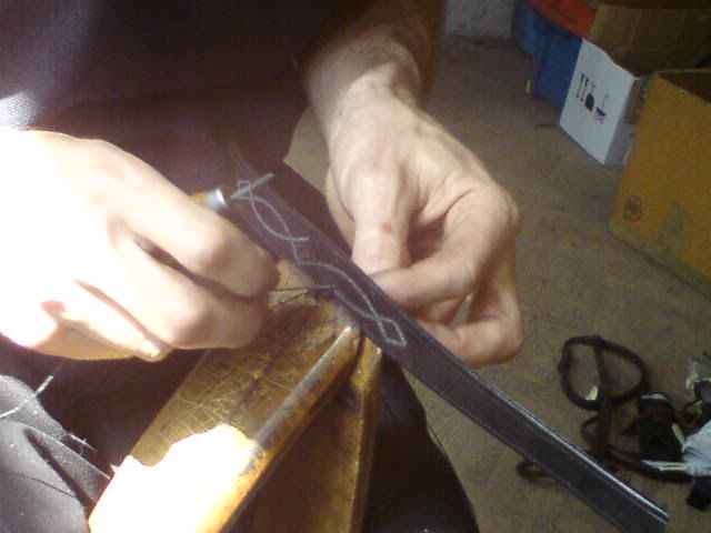

Now, all that is left is to stitch the bridle together. This is done using 2 needles, one each end of a piece of thread coated with beeswax (helps to waterproof the thread and helps the thread run through the leather easier) and a very sharp stitching awl. The item to be stitched is held in wooden clams between the knees. Here, you can see the awl, one of the needles, and the browband in the clams.
post-17557-083906400 1291135436_thumb.jp
Here you can see a very intricate design being stitched into a noseband of a different bridle. There are 14 stitches to the inch.

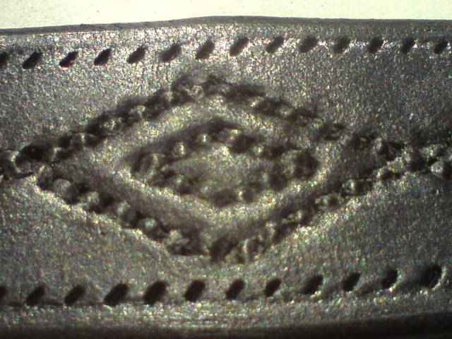

Here is a very much enlarged close-up of part of the design. You can see the 'pricked out' parts where the stitching will go, and part of the 'diamond shape which has already been stitched.
