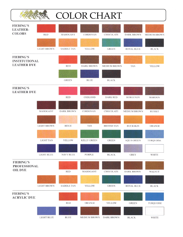

LNLeather Posted January 30, 2011 Report Posted January 30, 2011 (edited) Howdy Did you know you could go to Fiebing,com and look at their color-chart? That might be a good place to start. My guess is British Tan... Sure Hope this helps. Edited January 30, 2011 by LNLeather Quote ~Cheryl There are many things in life that will catch your eye, but only a few will catch your heart... pursue those...
