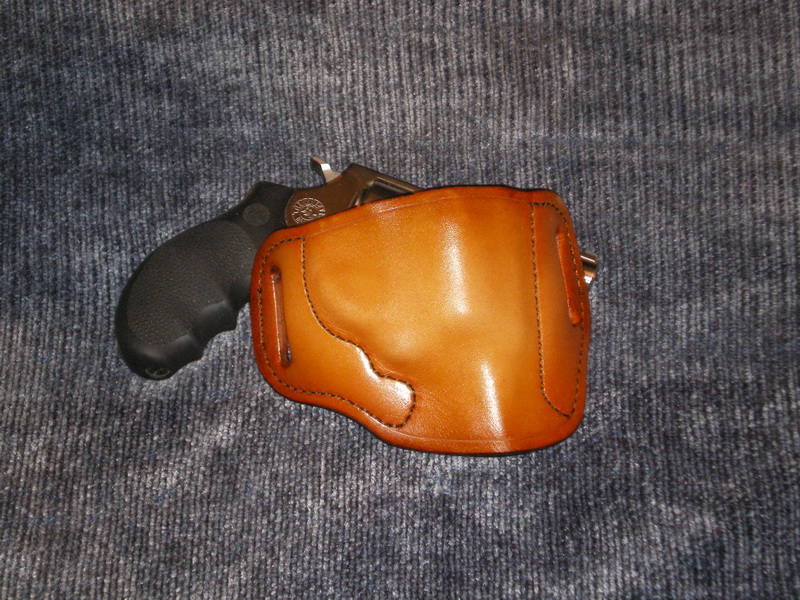

Members particle Posted February 5, 2011 Members Report Posted February 5, 2011 Hello all! This is my first attempt at a S&W J-Frame holster. I've made one California Slim Jim for a Ruger Single Six about a year ago, but otherwise - this is my first real attempt at a holster for a revolver holster. Anyway, I have a question and was hoping I could get some guidance... Please ignore the quality of the boning (or lack of) and the unfinished edges, etc. This was a mock-up more than anything to test the pattern and see how the tooling pattern came out (needs adjustments too). As it stands, this holster has excellent retention - it's not too tight, but won't fall out if I invert it and shake it. The cylinder on my S&W 642 has fairly sharp edges. As such, I'm not sure if I should mold the top edge of the holster around the top edge of the cylinder, or if I should just leave it loose up top and focus the majority of retention inside the trigger guard. I slightly pressed it inward, and now the cylinder is scraping up the interior of the holster a little. I've seen a lot of holsters that are tightly formed on the top, so I know it's not out of the question - but perhaps those particular cylinders have relieved edges? If it's tightly molded, do you then have to flare the top edge of the holster back out so the mouth of the holster doesn't snag on the forward edge of the cylinder? If anyone has example photos of revolver holsters that don't have retention straps, I'd love to see them. I was too lazy to get out the big camera, so these were just taken with my phone. Quote Eric Adamswww.adamsleatherworks.com | Facebook | YouTube | Instagram
Members dickf Posted February 5, 2011 Members Report Posted February 5, 2011 I made one quite some time ago as a prototype and I scalloped the cylinder area. Mine's an IWB, but I would use the same concept in knocking up a pancake if I were tasked with it today. Quote US GUNLEATHER www.usgunleather.com twitter.com/usgunleather facebook.com/USGUNLEATHER
Members Dwight Posted February 5, 2011 Members Report Posted February 5, 2011 FWIW, . . . I just use my thumb and ever so slightly "funnelize" the opening into the holster for the revolver. It adds a ton of strength to the front of the holster, . . . and kind of guides the thing down into the hole. I also don't mold the belt slots quite as much as you do. I let the wearer finish putting the "set" in the slots, . . . that way it has a tendency to mold more to him, and also help in the retention of the weapon also. I'm curious as to the weight of the leather you are using there also, . . . I usually lighten up a bit on any front side decoration or reinforcement. The sides look like they are a bit thick, . . . but it just may be the angle from which the picture was taken. Holster looks good to me, . . . good work. May God bless, Dwight Quote If you can breathe, . . . thank God. If you can read, . . . thank a teacher. If you are reading this in English, . . . thank a veteran. www.dwightsgunleather.com
Members particle Posted February 5, 2011 Author Members Report Posted February 5, 2011 Thanks fellas for the input. Dwight - The leather is Wicket & Craig 8-10oz. I was thinking about dropping down to 6-7oz on the reinforcement piece with my next attempt. Am I correct in saying you focus your retention in the trigger guard area? What weight are you using on similar lightweight revolvers? Quote Eric Adamswww.adamsleatherworks.com | Facebook | YouTube | Instagram

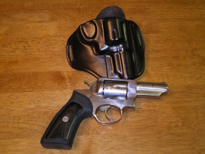

Members katsass Posted February 5, 2011 Members Report Posted February 5, 2011 (edited) Hello all! This is my first attempt at a S&W J-Frame holster. I've made one California Slim Jim for a Ruger Single Six about a year ago, but otherwise - this is my first real attempt at a holster for a revolver holster. Anyway, I have a question and was hoping I could get some guidance... Please ignore the quality of the boning (or lack of) and the unfinished edges, etc. This was a mock-up more than anything to test the pattern and see how the tooling pattern came out (needs adjustments too). As it stands, this holster has excellent retention - it's not too tight, but won't fall out if I invert it and shake it. The cylinder on my S&W 642 has fairly sharp edges. As such, I'm not sure if I should mold the top edge of the holster around the top edge of the cylinder, or if I should just leave it loose up top and focus the majority of retention inside the trigger guard. I slightly pressed it inward, and now the cylinder is scraping up the interior of the holster a little. I've seen a lot of holsters that are tightly formed on the top, so I know it's not out of the question - but perhaps those particular cylinders have relieved edges? If it's tightly molded, do you then have to flare the top edge of the holster back out so the mouth of the holster doesn't snag on the forward edge of the cylinder? If anyone has example photos of revolver holsters that don't have retention straps, I'd love to see them. I was too lazy to get out the big camera, so these were just taken with my phone. Particle, here's my personal carry holster for my old J framed Smith, and one made for a customer for a Charter Arms Bulldog.....no safety straps. The Smith M-36 has a hammer shroud on the holster because I carry it concealed, the Bulldog holster is for open carry...no hammer shroud. Mike Edited February 5, 2011 by katsass Quote NOTE TO SELF: Never try to hold a cat and an operating Dust buster at the same time!! At my age I find that I can live without sex..........but not without my glasses. Being old has an advantage.......nobody expects me to do anything in a hurry.
Members particle Posted February 5, 2011 Author Members Report Posted February 5, 2011 Katsass -thanks for the pics. Do you get plenty of retention just from the friction fit? Or did you do any boning on the back to lock the gun into the holster? Quote Eric Adamswww.adamsleatherworks.com | Facebook | YouTube | Instagram
Members marine mp Posted February 5, 2011 Members Report Posted February 5, 2011 (edited) Particle, My preference for the j-frame (alloy or steel) pancake is 8-9 oz in back (or against your body) and 6-7 oz. on the outside. I also don't re-enforce the throat, minimum boning except in the trigger-guard area and a straight shot up from the cylinder. As per Dwight, I also "funnelize" the throat opening for the cylinder.I also, make the holster in less of a "body molded" shape as I want the operator to tighten the belt in such a way as it pulls the thinner weight leather in the front just a little tighter against the weapon for added retention. Hope this helps some anyways. You have created quite a beautiful piece and I always enjoy the pictures of them. I really don't know how to post pictures, but when I do, I'll have some to show. My belief (JMHO) is that a lot of concealed-carry holsters are made with leather that is a bit to heavy for the piece. Thie holster is a "pocket" that is carrying a piece that doesn't weight a whole lot and leather is quite strong. Again, just my opinion. Semper-fi Mike PS. Question, not to steal this thread, PM if you wish. I realize you must sew as a last operation, so how do you keep it so clean? Thanks Edited February 5, 2011 by marine mp Quote "The first one thru the door...gets the copper-coated candy". ADL Custom Holsters "I've got a LONG list of real good reasons, for all the things that I have done"!!!
Members katsass Posted February 5, 2011 Members Report Posted February 5, 2011 Katsass -thanks for the pics. Do you get plenty of retention just from the friction fit? Or did you do any boning on the back to lock the gun into the holster? Particle, my holsters are made differently that most. I use two layers of leather bonded together, then stitched at all edges. Some think they are lined holsters, however, since I always use a minimum inner layer of 3/4 oz veg tanned instead of the more usual much thinner stuff, they really aren't truly 'lined'. Both of these holsters are made of 3/4 inside and 5/6 oz outer shell. My holsters are dried at around 130/140 degrees in the desert sun..........out here they dry very quickly. This produces a very firm and tight fitting holster (in my opinion much firmer than a single piece of leather of roughly equal weight) after hand molding only, as all of the rigidity is produced in the top (grain) layer of the leather. In my way, I have two grain layers which produce the better rigidity and firmness. Mike Quote NOTE TO SELF: Never try to hold a cat and an operating Dust buster at the same time!! At my age I find that I can live without sex..........but not without my glasses. Being old has an advantage.......nobody expects me to do anything in a hurry.
Lobo Posted February 5, 2011 Report Posted February 5, 2011 Paricle: As usual, your work shows outstanding skill and artistry. In response to your questions, I would offer: 1. The cylinder bulge can be used to increase retention qualities, if you wish to do so. Forming the holster mouth around the rear of the cylinder will serve this function. This also makes re-holstering more difficult, and you will probably note accelerated wear in this area after a brief period of use. Flaring the holster mouth slightly will facilitate re-holstering (as noted by others) while making little, if any, difference in overall retention qualities. 2. Pancake-style holsters, in general, get much of their retention qualities from belt tensioning which pulls the outer holster panel inward against the body. This is true for both revolvers and semi-auto handguns. The overall shape of typical revolvers presents some challenges, with the wide frame and cylinder bulge near the holster mouth and the narrow barrel lower in the holster; which is one of the reasons why pancake-style holsters are a prefered method for carrying revolvers. The trigger guard area is the most prominent feature that provides opportunities for enhancing retention in revolver holsters, and close forming and boning at the trigger guard will be more effective than just about anything else we can do on a revolver holster. 3. In my opinion, reinforcement bands or panels provide relatively little benefit on traditional 2-panel pancake-style holsters. Since the inner and outer panels are joined by stitch-lines fore-and-aft of the weapon, those are the points at which we can expect the holster to flex under pressure. Thus, the addition of another layer of leather serves primarily as added bulk (although your beautifully tooled panels are certainly an aesthetic addition) rather than actual reinforcement of the holster mouth. Personally, I have settled on 6/7 oz. veg-tanned for pancakes intended for the smaller and lighter handguns, and I think that it provides all the strength required for these applications. I usually use 7/8 oz. for most applications, and 8/9 oz. for the larger and heavier pieces. Your basic design for the traditional 2-panel pancake is much like my own, and I notice that you also pre-form the holster to body contour, which contributes greatly to function and comfort. Unlike some other makers, revolver holsters account for about half of my production (and the J-frame S&W's are very popular indeed). With your superior skills I think that you will quickly gain a following among revolver users as you develop your designs and add to your offerings. Best regards. Quote Lobo Gun Leather serious equipment for serious business, since 1972 www.lobogunleather.com
Members particle Posted February 5, 2011 Author Members Report Posted February 5, 2011 I appreciate everyone's input, and will take it all into consideration when I start making it again tonight. I also agree about the reinforcement on this style not really being necessary. I probably get 1 order out of 20 that doesn't want the extra piece, so I figure as long as people keep ordering them, I'll keep offering them. Personally, I like the way they look - that little visual detail, but agree it doesn't help much unless it actually wraps the mouth of the opening more like the Avenger style. Lobo - I agree with your comment in #1 about the accelerated wear if you crimp down the top of the cylinder area. I think I will focus my retention efforts in the trigger guard, and leave it at that. Marine MP - I cut, dye, sew, then form. If you'd like to know more, here is my basic workflow: Cut my pieces Mark the stitch lines Tool if necessary Groove Edge the stuff I won't have easy access to later Dye Burnish the edges of the reinforcement pieces Glue the reinforcement pieces on the body Sand the edges flush Edge Stitch Glue the front face to the back face Sand Edge Stitch Apply maker's mark (Dampen specific area with a sponge, then stamp - much easier to do this prior to actual forming) Wet form Dry in oven at about 135 for about 40 minutes Air dry overnight Gum Trag the interior Dye and burnish the edges Oil the grain side and let rest for 12-24 hours Apply finish and let dry Apply 2nd coat of finish and let dry Quote Eric Adamswww.adamsleatherworks.com | Facebook | YouTube | Instagram
