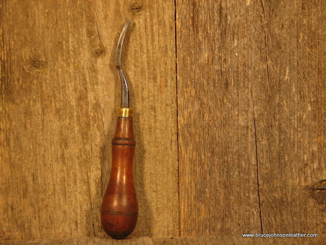

Moderator bruce johnson Posted February 14, 2011 Moderator Report Posted February 14, 2011 I don't know if it is a trick or not. I use a round bottom kind of French edger with some sweep to it. If I sew dry to avoid a rat butt pattern on top, then I spritz a little water on the bottom and let it soak in before I trim it. Cutting the binding with this tool and little moisture makes a nice slick edge. I just kind of try to run one rail over the stitchline and so far I haven't cut any off. If you keep the toes ground off the tool, you can run it right up into the corners. My leather is probably 6/7 or so there. This is an old Osborne #1 and it works. Quote
Members BondoBobCustomSaddles Posted February 14, 2011 Members Report Posted February 14, 2011 I use a "cantle binding edger" that I got from Weaver. It has about a 4"/5" long curved front before it gets to the actual edger part. It has what looks to be a #3 french edger on it. It works really slick and makes triming off the excess easy. Bob Quote
