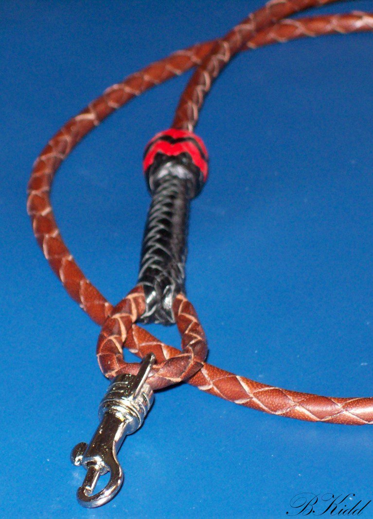

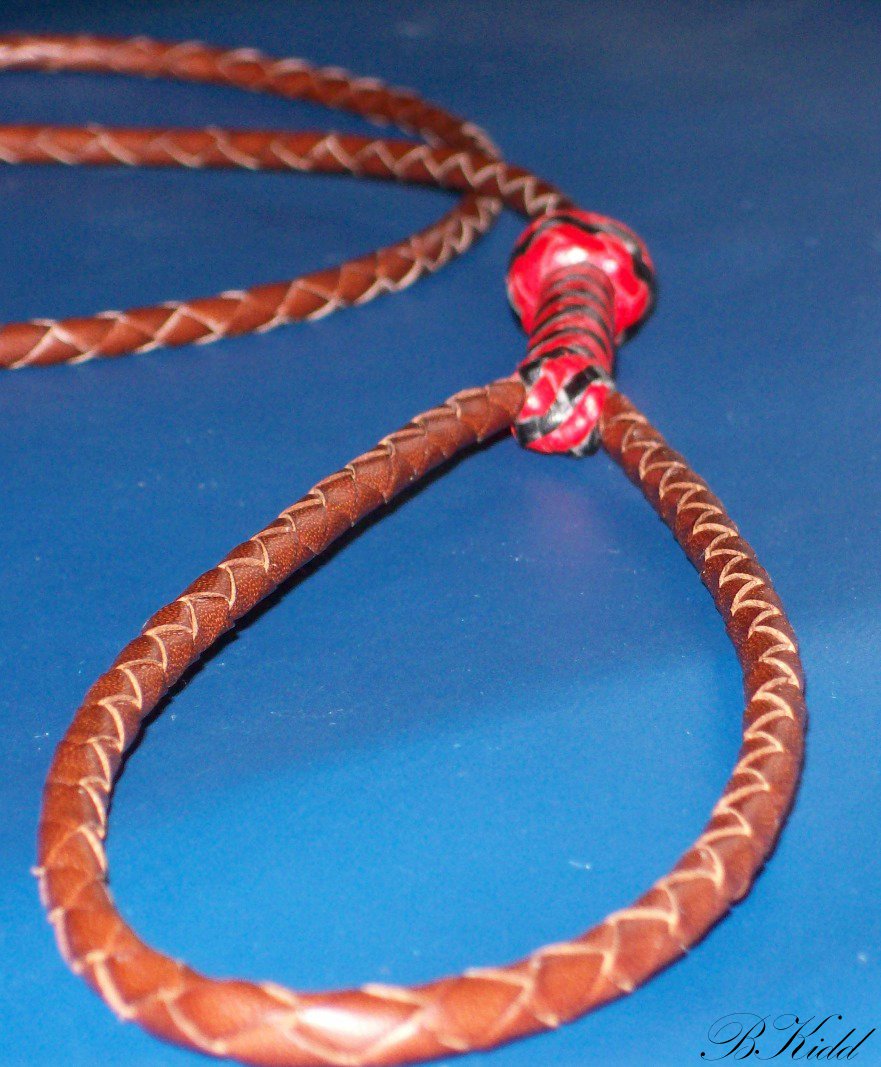

Members Tracym Posted November 15, 2013 Members Report Posted November 15, 2013 Oh no, the photo is gone - put it back! I was trying to figure out the covering for the back braiding - you said "2 Split T braids at top and bottom in 12 strand round plait herringbone braid". Any tips on where I could find instructions for that? I do have the Grant book, but find it a bit confusing at times. Last time I tried (and failed haha) it looked to me like there were only 4 strands going between the two sides of the hand loop, but you ended up with 12? I'd really like to upgrade my leads and add something like this. Thanks! Quote

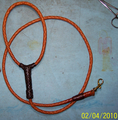

Members KnotHead Posted November 16, 2013 Author Members Report Posted November 16, 2013 I've re-attached the photos with one extra leash I did for my then boss. I have the layout photos somewhere on my other PC. I just have to locate them. Brian... Quote

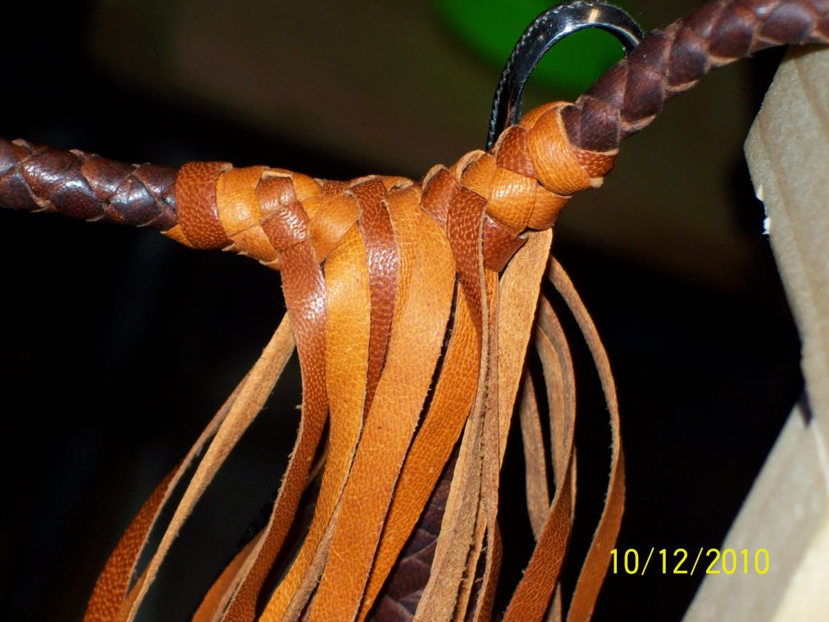

Members KnotHead Posted November 17, 2013 Author Members Report Posted November 17, 2013 This probably wont show you exact details. But will give you the idea of what to do. I'll try to explain what I did as I go with the photos. Taking 2 strands and dividing them in half to create a 4 strand round braid on both left and right hand sides in order to bring them to the center. You can of course make these as long as you wish. As you can see by the photo the individual braids came together in the center. This will now give you 16 strands to work with. From this point any pattern can be created to braid down for covering back braids. As you can see from this shot I have created the pattern I want to use. At this point the braiding is just like braiding around a core. As I braid down, I am watching the back side as well. Checking to be sure that the braid is lining up and closing up so that there are no gaps in the braid. You can finish this type of braiding off by 2 methods. Employ the Fid work style finish. Make a knot that will cover the ends. Much of this braiding style was figured out and done by trial and error and lots of frustration. But it has been well worth the time and effort. I believe that this adds another touch of dimension to your skill sets as a braider and also adds dimension to your actual projects. It might take a little longer to do this. But the outcome is worth it at least I think so. Brian... Quote

Members Tracym Posted November 18, 2013 Members Report Posted November 18, 2013 That is SO kind of you to go to the trouble to put up such detailed instructions. Just a few questions - you say two 4-strand round braids, then you end up with 16 strands? Wouldn't it have to be 2 8-strand braids to equal 16? Is that the same method you used on the one with the red - just quite a bit less of the two round braids? And finally, what is "Employ the Fid work style finish"? Thanks so much for you help, I am satisfied with my actual braiding now and am looking to upgrade adding some fancier stuff. Quote
Members KnotHead Posted November 18, 2013 Author Members Report Posted November 18, 2013 (edited) The fid work styled finish is just a back braid sort of. You would actually extend the strands down in a 45 degree helix and lash that off and then build you finishing knot from all the strands. It would be considered a very short fid work knot, or a multi-stranded knot. You would actually get 8 strands on both front and back for a total of 16 strands all together. It is the same method I used on the red and black leash. Thanks all for the very kind comments. I will say that this braiding technique is not my own invention. I however, have not seen any type of instructions for it anywhere as of yet, or in any book that I know of. I could be wrong on that. But, with that in mind. I may just have re-discovered something done in the past and just brought it out today. Who knows. LOL... Brian... Edited November 18, 2013 by KnotHead Quote
