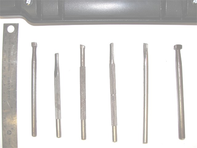

Members J D Posted March 12, 2011 Author Members Report Posted March 12, 2011 Thanks for your reply and information. Am attaching a couple of photos of some 'vintage' tools that I have. They are all bevelers. Some have knarly grips and some are smooth. I believe they may be from one or two of the notable tool makers. Any help you can give me would be appreciated.....thanks again....jd Quote
King's X Posted March 13, 2011 Report Posted March 13, 2011 Some of those bevellers appear to be resemble my Hackbarth-Barnes bevellers, which are currently HQ'ed in Elfrida, Arizona. First picture, (left to right) numbers #2,3 &4. Numbers #1 & 6 appear to resemble Craftools. Number #5 looks like a handmade stamp. I hope this helps. Quote Greetings from Central Texas! The Grain Side Up blog #TheGrainSideUp
Members J D Posted March 13, 2011 Author Members Report Posted March 13, 2011 Appreciate your response. I was thinking that a couple were old hackbarths'. Just getting involved with this site and really beginning to like it. Thanks again....jd Quote
