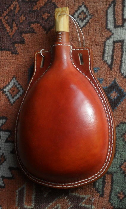

MikeCahill Report post Posted March 6, 2011 A BEAUTIFUL flask, I used to make weed pot similar to this, and a friend used to macrame (knotting string) ropes for them, The method I used was different, I carved half of the bottle shape out of wood, and mounted it on a stout board, I also cut out a piece of ply the same outline as the wooden forme, but 3mm clear all round, I then would staple a piece of soaking wet leather to it, and clamped the leather over the former, after a couple of days in the press, the shape was fixed, I would glue both halves together and hand stitch, I don't think I managed to make one as nice as yours though! Quote Share this post Link to post Share on other sites

Brushpopper Report post Posted February 6, 2015 (edited) I've posted this on 'Show Off'. Hope it's okay to repeat it here. It's a flacket from the Mary Rose made with wooden formers. It's flatter on the back to lie comfortably against the body. Edited February 6, 2015 by Brushpopper Quote Share this post Link to post Share on other sites
