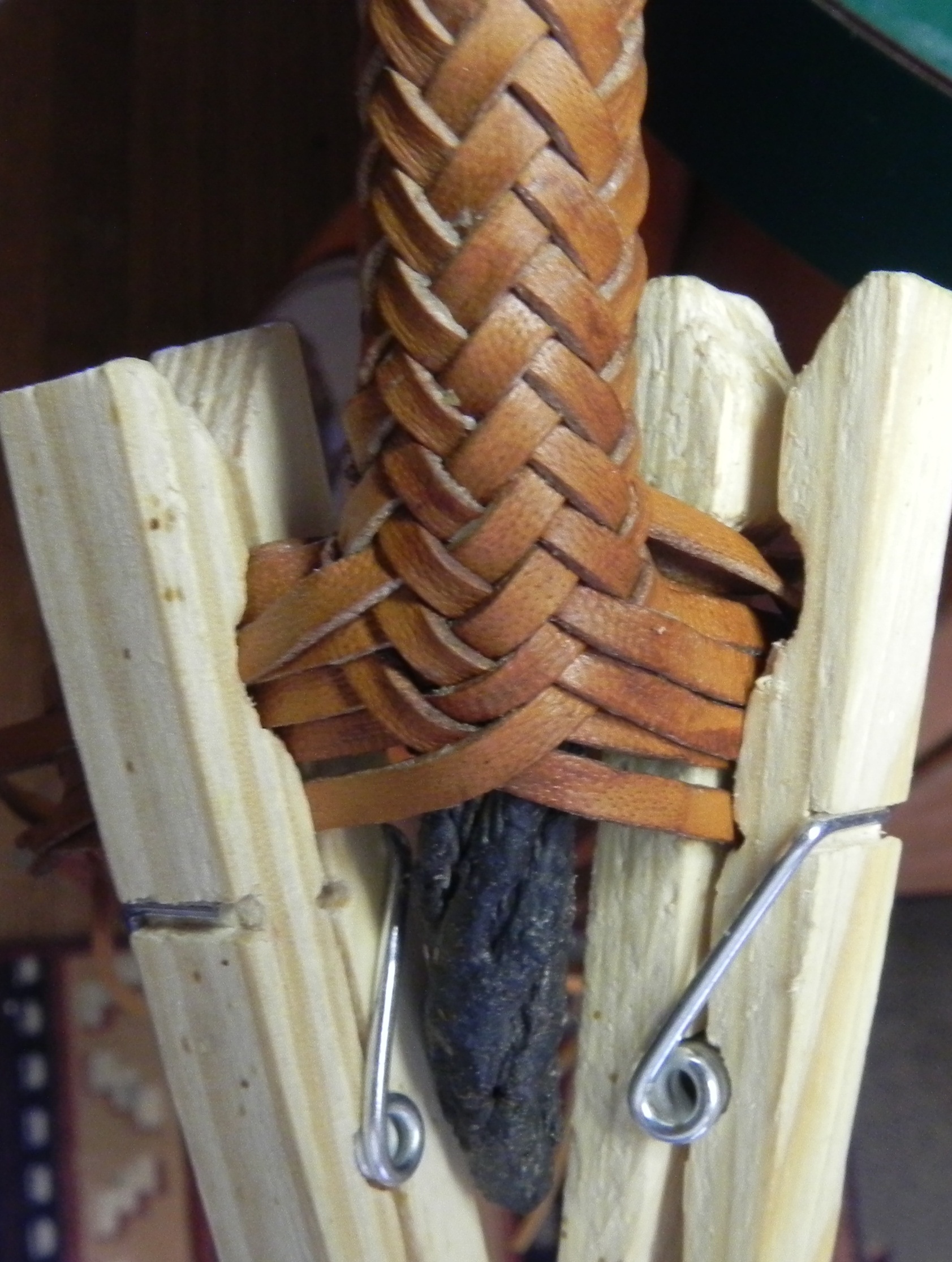

Members Melanie Wilfong Posted April 23, 2011 Members Report Posted April 23, 2011 This is a 16 strand around a steel cable which tapers down at the end. How would you suggest tapering down? I've seen a very good video which tapers over a larger area in a number of steps, but since this is only about 1" I'm not sure what to do. It's a quirt. Thanks Quote
Members roo4u Posted April 23, 2011 Members Report Posted April 23, 2011 i would try just continuing my braid but pull more downward on the tapering part to try to get it to snug up a bit tighter. then if that didnt work unbraid and try something else...its not much distance so not hard to undo and retry. Quote TRACY MONSTER FARM SPECIALTIES-custom tack for dog, horse and human
Members KnotHead Posted April 24, 2011 Members Report Posted April 24, 2011 (edited) I would have started dropping strands out of the braid at about 12in from the end of the quirt. Dropping 2 strings at a time till you reached the end where then it should be down to a minimum of 4 strings or even 8 strings. But that's me and how I would have handled that. B... Edited April 24, 2011 by KnotHead Quote Best Regards, Brian Kidd
Members Stan Posted September 22, 2015 Members Report Posted September 22, 2015 Howdy! Can you file or cut the cable on a taper? Or considering cutting your lace strands on a taper. I'd advise using scrap lace first to make sure it will work for you. From what I can see you are doing nice work. Stan Quote
Members Ccastle27 Posted September 23, 2015 Members Report Posted September 23, 2015 Looks like you've got enough room for basically one more full pass - try dropping the front two strands into the middle, plait the back two, drop 'em, plait, drop 'em etc. until you are down to 4 or 6 plait with the remainder coming through the middle. Then you can finish with a crown knot and trim the ends up. -C Quote
