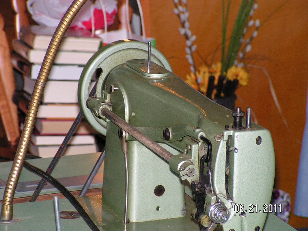

I was hoping one of you may be able to help me with identifying and providing a few details on this machine.
I'm trying desperately to find a machine to learn on and also see if it is worth investing in a new machine for the amount I will use it. I have come across very few used sewing machines in my area and the 2 I wanted were (IMO) priced way too high. Both were Juki LU563 and one was 1600 and the other was 1800 but had some thread.
This one is very low priced and I can't seem to find any info on it. The person selling it doesn't seem very knowledgeable about it and isn't very tech savvy and took 4 emails to get me these pics and they aren't that great of angles.
Any help would be appreciated. Thanks in advance.

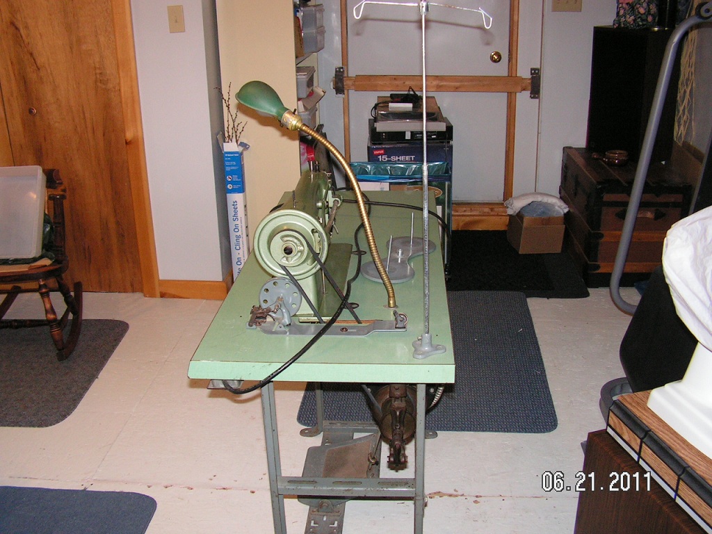

Do you think you could tell me a bit of the details on this machine? Is it built the same or similar as a more common machine that there would be more info on?

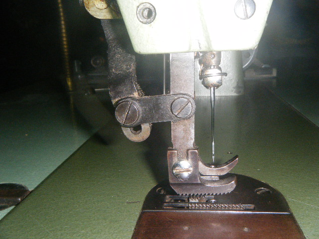

The photos don't show the pressor foot/feet, so it's hard to tell if it is a walking or snapping foot machine, or straight needle.
The first photo, of the right side, shows what looks like an ancient external clutch, for the motor, but I could be mistaken.
Aside from those things, it looks like it is in relatively decent external condition. You'd need to inspect it in person and maybe take some decent photos of the head area, where the feet, throat cover/feed dogs and needlebar are located, as well as the back or left side shot of the head.
If you see in in person and test it and it runs smoothly, make an offer and see what it can do for you.

Yes,it has a walking foot,that has teeth on them that will probably have to be ground down so they don't mark.

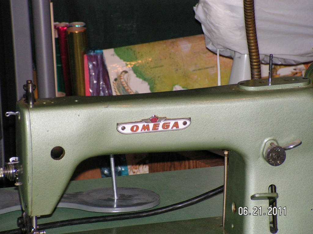

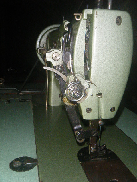

I was looking at the parts manual and on the back it says TDU N62, I think this is actually the model number and the other number that the seller gave me originally was the serial number.
In any event, here are some more pictures.

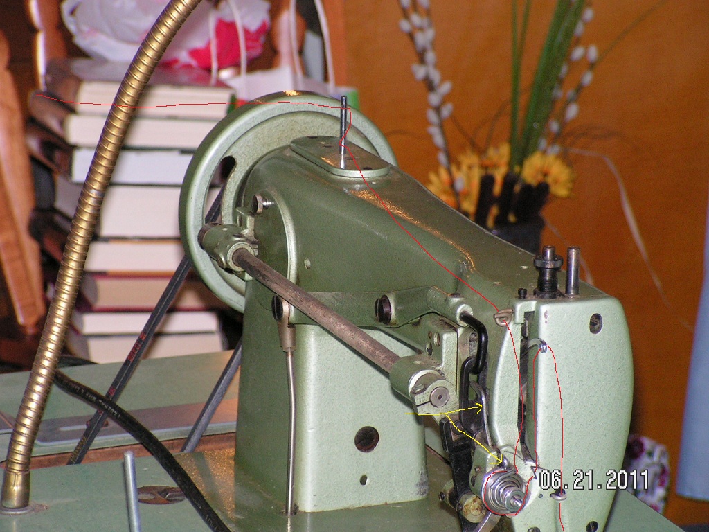

Well, the machine is lubed well. With the belt off, I can very easily roll the hand wheel. That silver knob I've figured out is the stitch length and have got it freed up and functional and I can easily adjust it. I also cut off that old plug and put a new one on
I've tried sewing with it, I found some upholstery thread, I think it's #69 although it doesn't say on it anywhere, found some #20 needles which seem too large for the thread. I'm looking into getting some better suited thread and the appropriate sized needles from Bob, however, I'm having a heck of a time getting the adjustments for the tensions right. Some times the thread ends up with huge loops all mangled on the bottom other times the thread is straight across the bottom.
I don't know for certain that I have it threaded right. I think I have the jist of how to thread it but the top tension seems off. I'll post a pic to show what I have done. I'm a bit confused by this one bar (yellow arrows) It sits in a link on an arm near the top and has a pivot point and then a "hook" that sits in between the top of the two disks of the top tension. I think I have something wrong there.

It looks like it's threaded corectly,do you have the thread pulled down in between the tension discs on the side?It looks like the thread is just setting around the outside if the tension.
