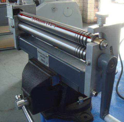

Members impulse Posted June 28, 2011 Members Report Posted June 28, 2011 (edited) I previously posted for help in making a splitter and have since been investigating modifying a metal working slip roller. These cost around $175 new and seem to have most of the components needed for a hand cranked splitter. The width of rollers is 300mm(12") and maximum adjustment between rollers is 2.5mm(6-7oz leather), but with modification this could be made to accept thicker. I am looking at the possibility of replacing the third roller at the back with a blade. I would need to get the angle right, something I need your help with. Anyone think that this is a feasible solution? Lois BTW the wire rolling grooves at the end of the rollers could make interesting border patterns! Edited June 28, 2011 by impulse Quote
Members wolfe9 Posted June 28, 2011 Members Report Posted June 28, 2011 (edited) I think you would need to eliminate the back roller for starters , Im not sure it would work to well with smooth rollers and with the off set of the rollers , the offset will present the biggest challenge (getting it to feed the leather straight) , you might be able to make 2 arms to move the top roller back . I can send you a pic of a 5 in 1 to show blade position if you need it ... PM sent as well ... Edited June 28, 2011 by wolfe9 Quote
mike59 Posted June 28, 2011 Report Posted June 28, 2011 I previously posted for help in making a splitter and have since been investigating modifying a metal working slip roller. These cost around $175 new and seem to have most of the components needed for a hand cranked splitter. The width of rollers is 300mm(12") and maximum adjustment between rollers is 2.5mm(6-7oz leather), but with modification this could be made to accept thicker. I am looking at the possibility of replacing the third roller at the back with a blade. I would need to get the angle right, something I need your help with. Anyone think that this is a feasible solution? Lois BTW the wire rolling grooves at the end of the rollers could make interesting border patterns! Your bottom roller would need to be finely fluted lengthwise to feed the leather through, and a very true solid bed for your blade to mount to. Quote
Members impulse Posted June 29, 2011 Author Members Report Posted June 29, 2011 Thank you Mike and Wolfe - very helpful imputs! Pics would be great and any other comments welcome. Lois Quote

Members amuckart Posted July 4, 2011 Members Report Posted July 4, 2011 To what extent have you looked at the workings of crank splitters in person? I suspect that you'll put more than a few hundred buck's worth of work into modifying this thing before you even try making and heat treating a blade for it, only to end up with something that won't work as well as a purpose-designed splitter would. There's a lot more to them than the rollers, and there's a reason they cost what they do. I was lucky enough to get two 6" crank splitters cheap, but they needed work and just setting them up again post-assembly was hard, let alone building one from scratch. Given the initial cost, and the work it took to get them going I wouldn't let either of them go for less than several hundred dollars. If I were going to make a crank splitter this big I'd start by working out where to get single-bevel blade made in high-quality tool steel so that it comes out completely flat and true. For something with a finished size of 300x40x5mm, that's a non-trivial task in itself. Next you need to find somewhere that can mill lengthwise grooves into the bottom roller close enough together to give you the good sharp ridges to feed the leather. Unless you own, and can program, a CNC milling machine, those two operations alone will set you back the price of a second hand splitter. If you do own a CNC milling machine, then you're in a good position to make the rest of a splitter too. Quote -- Al. Medieval Stuff: http://wherearetheelves.net Non-Medieval, including my machines: http://alasdair.muckart.net
