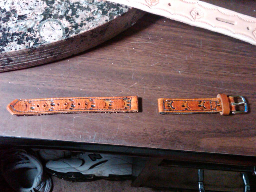

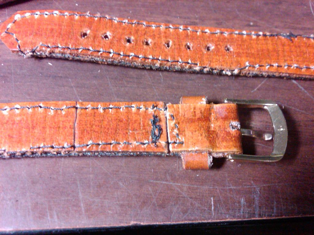

Members TomG Posted June 30, 2011 Author Members Report Posted June 30, 2011 Do you have a picture of the watch band? A 111W is a pretty big machine for doing this kind of work. What size and point style of needle are you using? My guess would be that the leather is getting pushed down the hole in the needle plate as you try and sew right close to the edge. You'd probably be better off with a lighter wheel-foot machine for things like watch straps with a needle plate that has the smallest feasable hole in it. I think it's a 20 or 22.. Don't remember. But it is not a leather needle. The only leather needle I have right now is a 23. It's huge for this band I'm attaching some photos. Thanks Tom Quote Tom Gregory Legacy Leathercraft www.legacyleathercraft.com www.etsy.com/shop/legacyleathercraft
