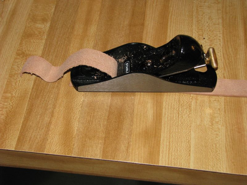

Contributing Member TwinOaks Posted July 13, 2011 Author Contributing Member Report Posted July 13, 2011 EDIT...the pic didn't paste like it should....working on it.....My link The Lowe's website lists this as a block plane, but I think the picture is a bench plane....which is what I got. The Block plane has a steeper angle to the blade, like close to 60 degrees. The bench plane has a much lower angle, as you can see in the pic. I'll see if I can get a few pics of it in use..... And, yes, probably more than a few people have some of these in Grand Dad's tool box. My dad is going to check out my grand dad's tool selection and see if he left us one of the big ones. Quote Mike DeLoach Esse Quam Videri (Be rather than Seem) "Don't learn the tricks of the trade.....Learn the trade." "Teach what you know......Learn what you don't." LEATHER ARTISAN'S DIGITAL GUILD on Facebook.

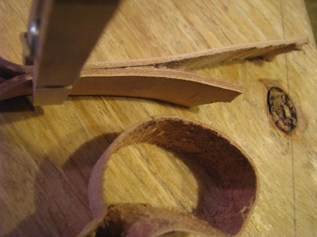

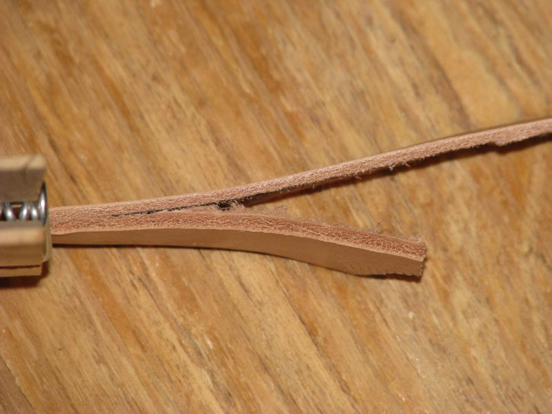

Contributing Member TwinOaks Posted July 13, 2011 Author Contributing Member Report Posted July 13, 2011 Okay, a few pics: #1 plane growing a leather ribbon out of its head.... #2 split leather and unsplit section of the same strip #3 same, with the ribbon of leather I split off of it. Quote Mike DeLoach Esse Quam Videri (Be rather than Seem) "Don't learn the tricks of the trade.....Learn the trade." "Teach what you know......Learn what you don't." LEATHER ARTISAN'S DIGITAL GUILD on Facebook.

Members evandailey Posted July 13, 2011 Members Report Posted July 13, 2011 (edited) EDIT...the pic didn't paste like it should....working on it.....My link The Lowe's website lists this as a block plane, but I think the picture is a bench plane....which is what I got. The Block plane has a steeper angle to the blade, like close to 60 degrees. The bench plane has a much lower angle, as you can see in the pic. I'll see if I can get a few pics of it in use..... And, yes, probably more than a few people have some of these in Grand Dad's tool box. My dad is going to check out my grand dad's tool selection and see if he left us one of the big ones. Actually, what the picture shows and what you have is in fact a block plane. I've been a woodworker much longer than I've been a leather worker. Block planes are designated as such because the bevel is up on the blade. On a bench plane the bevel goes down. Therefore, block planes can have a much lower attack angle than bench planes. I am surprised you were able to get that Lowe's grade stanley to do that. I have some higher end planes that are SHARP and I have not had great success trying to do what you're showing, but I didn't give it much effort either. Now that I see your results I'll have to get it another shot. Did you start feeding the belt into the plane right at the end or did you start a little ways into the belt? Edited July 13, 2011 by evandailey Quote
Contributing Member TwinOaks Posted July 13, 2011 Author Contributing Member Report Posted July 13, 2011 Actually, what the picture shows and what you have is in fact a block plane. I've been a woodworker much longer than I've been a leather worker. Block planes are designated as such because the bevel is up on the blade. On a bench plane the bevel goes down. Therefore, block planes can have a much lower attack angle than bench planes. I am surprised you were able to get that Lowe's grade stanley to do that. I have some higher end planes that are SHARP and I have not had great success trying to do what you're showing, but I didn't give it much effort either. Now that I see your results I'll have to get it another shot. Did you start feeding the belt into the plane right at the end or did you start a little ways into the belt? Thanks for the clarification on the plane types. I learned a little today. I was going by the label on the package, one said block, one said bench. As far as using a Lowe's grade stanley.....what can I say? I know how to sharpen steel. I'm not starting right at the end, I'm leaving a little tag end and starting perhaps 1/2 an inch from the end. Quote Mike DeLoach Esse Quam Videri (Be rather than Seem) "Don't learn the tricks of the trade.....Learn the trade." "Teach what you know......Learn what you don't." LEATHER ARTISAN'S DIGITAL GUILD on Facebook.
