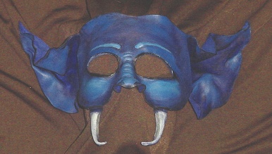

Members TomBanwell Posted June 3, 2008 Members Report Posted June 3, 2008 Russ, for my masks I needed a clear sealer. I tried Krylon Matte Finish #1311 which I use regularly on wood and resin, and it turned white on the leather. Bad news! Then I tried Krylon Crystal Clear Gloss #1301. It works great on leather, but beware that it is gloss. I then tried Krylon Crystal Clear Matte, and it turned white! Apparently the flattening paste (as I understand it) that is added to clear lacquer is turning white on contact with leather. I don't understand why, as it works fine on wood, but it does. So stick to gloss and you'll be fine. Quote

Members swivelsphinx Posted August 26, 2008 Members Report Posted August 26, 2008 I know many mask makers who use Krylon products to finish their pieces. Personally, I find that if a mask is going to flex alot it the finish *will* "break" and spiderweb eventually. It's good to inform customers how to properly store their masks. Little thin masks ("lone ranger style") often end up bent up in drawers, or "rolled", which can wreck a poly-whatever finish. At least the customer can't say you never warned 'em! I am not all-against Krylon- I use their products on alot of things. On leather, it's economical, fast and reliable. *However*, spraypaints of any kind can dry out the leather and make it terribly brittle. My masks tend to be single piece half-face jobs. I use dyes overlaid with acrylic. I tend to use finishes like atom wax- they harden a little, but still retain some "give". Quote "Where there's a witch, there's a way!"
