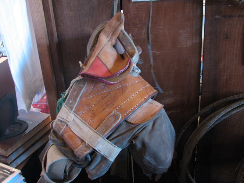

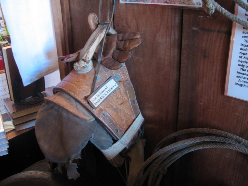

To clarify for some of the people reading this thread and wondering what the heck these guys are talking about - here are some pictures of a bareback rigging that belonged to one of my good friends. Pete made it for him and Pete is being kind of humble here. He was THE maker of these and when you arrived, it was usually in a Hennessey rigging.
