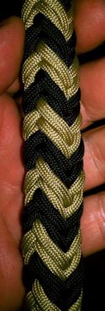

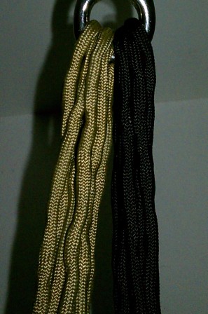

I am trying to learn how to make a 2 color square braid (whip?) It was made with 2 colors of paracord. 4 strands of each that doubled over a clasp making 8 strands of each color for a total of 16 strands? post-18296-048684200 1314914017_thumb.jp (I pulled the braid apart in an attempt to learn how to braid it but I failed) post-18296-046991300 1314914026_thumb.jp The finished braid formed square braid post-18296-014851100 1314915369_thumb.jp(whip like) post-18296-078301900 1314915354_thumb.jp Does ANYONE have a clue what I am talking about because obviously I have no idea! If anyone can tell me how to do this braid or even explain better what i am trying to explain I would be VERY grateful!

I know a little about braiding paracord. You can arrange the cord in many ways to get alternating color patterns. Basically your braiding will start buy bringing the highest outside strand ( left or right doesn't matter ) bring it around behind to the opposite side, split 4 and bring to the front of the side it came from. It should be your lowest strand on that side now. Then take the highest outside one from the opposite side and do the same, bringing it around behind splitting 4 on the opposite side and back to the front on the side it came from. It should be your new lowest string on that side. Hope this helps, good luck

any round braid done without a core will end up square. is the pattern in the picture the one you want to end up with cuz how you set up your strings will determine what pattern you end up with. braiding with 16 is really no harder than 8 same basic skills just more strands to deal with. if you let me know what pattern you want to end up with i will do a short tutorial for you on how to start the 16 strand.

Sadly yes that was the item that I unbraided... 16.gif No I did not purchase it but it was bought for me...LOL It was what as know in the biker community as a "Get Back Whip" they were used to slap onto the hood of cars that rode up to close to bikers back in the day. Now they are used more for showing club colors.

Honestly I am not sure it looks like it maybe close but mostly what I want to do is show the two colors (equally) in a pattern the entire lengths. Also I plan (If I learn how?!?) to make these in lengths for about 2-4 feet in length but I want to be able to also have some girth (my life story right there) of upwards of 2 inches?
