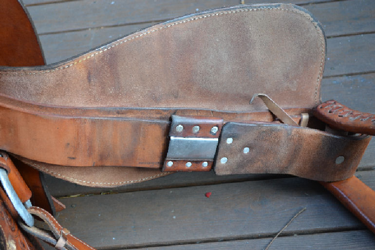

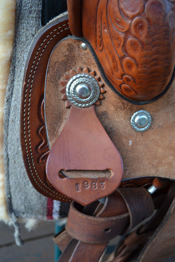

I just purchased this saddle for 150 of of craigslist. Took it to a saddle repair shop and asked for them to shorten the fenders and condition it. He said that he couldnt make the fenders shorter and reccomended that I buy a new saddle from him.....OK. He told me that this was a mexican made saddle and it was crap but said that He would buy it from me for 120.00...HUH? anyway I like the tooling on it. The tree is rawhide covered, and the leather is thick, much thicker than todays saddles. It is pretty heavy but I havent weighed it yet.
The guy I bought it from said that his mom had it custom made in the early .80s by saddle maker in the pacific northwest. I live in Wa state. His mom had the saddle in storage for several years and when she passed away they cleaned out the storage and found this. It was dry but not cracked and the fenders are STIFF but in good condition otherwise. Im new to the picture posting so forgive me if they dont turn out! Does anyone have any info on this saddle or can give me good advice?

I cannot really tell too much from the pictures. If it was hand made or custom made it would most likely have a makers stamp somewhere. It not then it is most likely inported. Did you get ripped off? I don't think so, you are into it for 150 and that is about what it's worth. If you were closer to me I would tell you to bring it by and I would shorten the stirrups for you. But I am up close to Kansas City. If you cannot find someone to do it you can always ship it to me. Contact me off list if you are interested. Randy

This is clearly a shopmade saddle(not a mexico) and I would say it probably was made in the 80s.I would say its a 150 dollar saddle as long as the tree is sound and fits a horse. There should be no reason a good saddle maker couldnt shorten the fenders for you.might try another shop

There are a couple of tell tale signs that the saddle is from a production shop probubly south of the border, the finish nails in the front of the seat leather above the concho I have seen used on those saddles a lot. the style of the cantle assembly is used on some from this type of manufacturer. You may find that staples are used in assembly and there are only 1 or 2 screws holding the rigging along with staples. Look at the ground seat strainer, there may be a "kink" in the metal (look under the saddle between the skirts) I have seen them bent so much that they are sure to sore a horses back right on the spine.
Look for nails or screws along the bars. Many times thay are put there to hold the skirts on and seem to work their way out (may sore a back)
The tooling appears to be "pressed" in and hand detailed. This is done many times to give a hand tooled look.
There should be no reason the the stirrup leathers could not be shortend. Try another shop !!
If there are no safety issues (rigging and stirrup leathers) and nothing to sore the horses back, it should be o.k. to use.
Be sure to change the billet and off side billet. There is no way they are safe given the information that the saddle was stored for years. These should be changed at least once a year anyway with normal use and care.
With these saddles (if it is what I think it is, made in mexico in a production shop) the leather may not condition well. If it is soaked to much with oil it will begin to break down and fall apart. Also, if the shirts are "plugged" with cardboard (yes most saddles like this are) the oil will destroy it and fall apart. So be careful how much you condition or oil the leather.

That saddle fellow is full of hooey if he told you the fenders can't be shortened. I've done it. I make a pattern of the top of the fencer, reduce it by how much the owner requests, I then use the paper pattern to reshape the top of the fender to resemble the original and reattach to the stirrup leather.I suspect your fenders aren't as high as they can go. You might be able to push them up another 3 or 4 inches. Since the stirrup leather wraps around the tree it may not want to budge. I push up on the fender with one hand and pull down on the stirrup leather with the other. Grunt like hell. It helps. Let us know if you can't get them to move. Once your fenders are higher you can adjust the stirrup length.

I've now looked at the pics and I think you got yourself a good deal. I've worked on hundreds of saddles and yours is right in the middle for quality. There is nothing to prove the saddle is Mexican made (apparently in a derogatory tone). I suspect that repair person knew he could turn a good dollar on your saddle.
