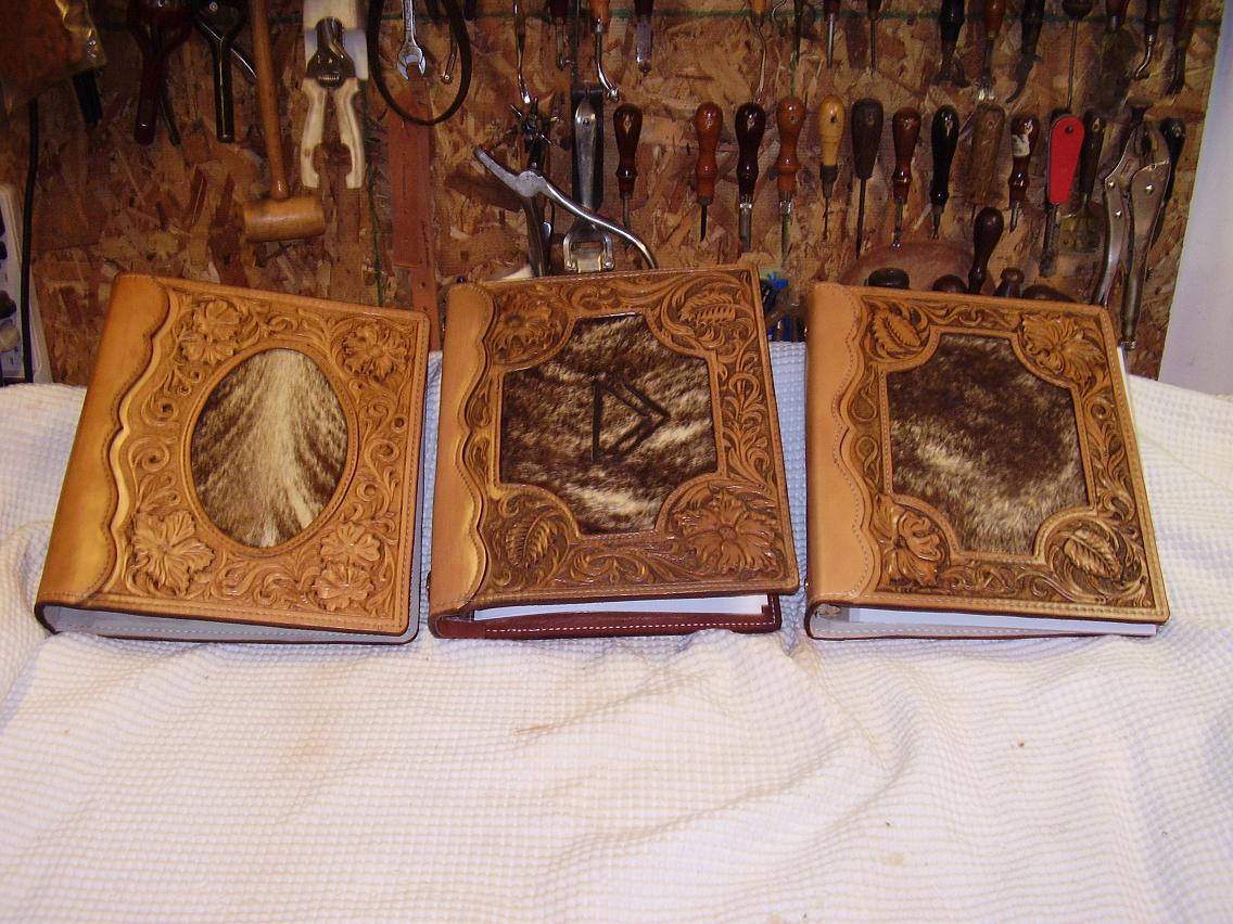

Members BondoBobCustomSaddles Posted December 5, 2011 Members Report Posted December 5, 2011 Hi All, I haven't posted any work in a while. I've been really busy, but; just no time to get anything posted. This year I had some orders for photo albums, which I have never made before, however; since it was a friend that wanted these, so I stopped working on saddles long enough to do these for him. Thought that I would post. Sorry about the quality of the pics, just one of those things i still have to master. At least I think that I have finally found out how to make pics smaller. Hope that he will like them. He hasn't seen them yet. Bob Quote

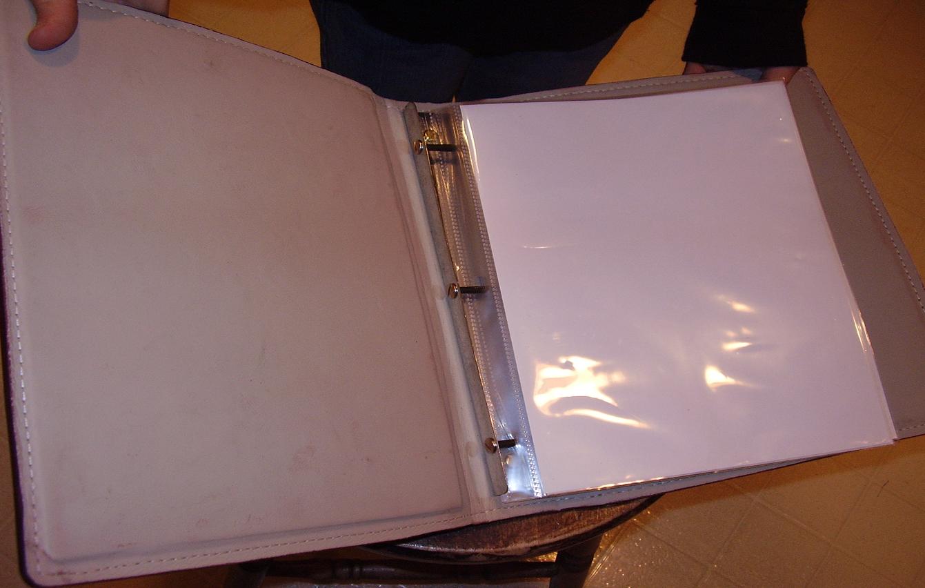

Members BondoBobCustomSaddles Posted December 6, 2011 Author Members Report Posted December 6, 2011 Thanks Leatherworker. As for the thickness of leather, like I said in the post, mostly I make saddles, tack and chaps, except when that little outlaw in side of me commits me to make something, when I am asked and can't say no. After I have said sure I can do that, then I use what I have around which is mostly 12/13 oz, 13/14, and chap leather. Mostly that is what I use, and when I need something less, I skive it. In the case of these albums, I used 12/13 oz mostly for the covers, and the inards on the one with the brand on it was 7oz buffalo, the other two were covered inside with 2/3 oz uppolstery hide. This is the first time i made these. If I were going to make a lot of them rather than skiving the edges down to give the less bulky appearance, I would just order leather more appropriate for the job. I would probably use 8/9 on the covers and 2/3 on the inside covers. Also I did not like the snap ring holderes ao I made my own with some 1 3/8" aluminum channel I made. Bob Quote

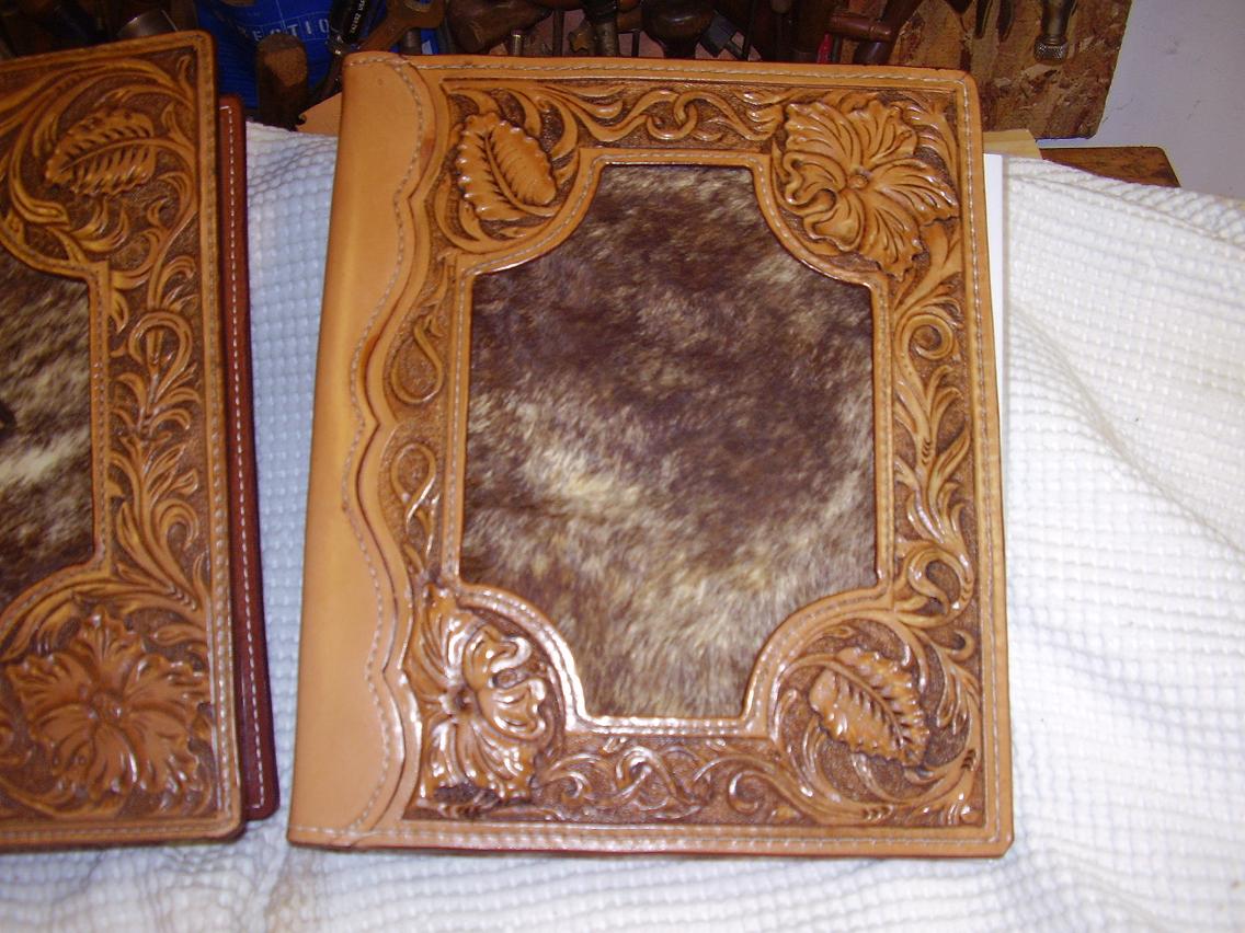

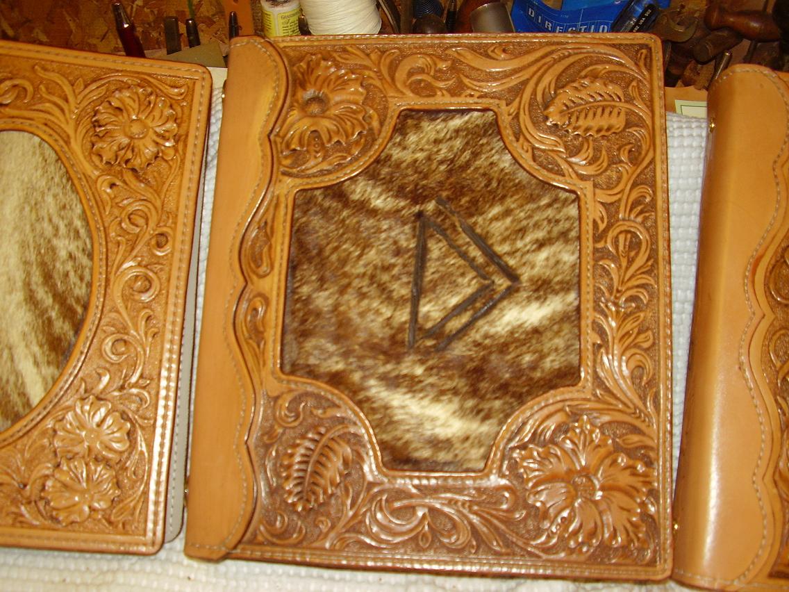

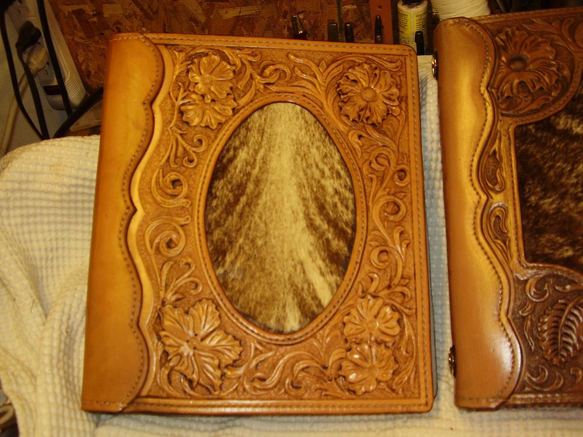

Members BondoBobCustomSaddles Posted December 6, 2011 Author Members Report Posted December 6, 2011 (edited) Well Pete, I will try to explain how I did it, and hope it makes sense. I first measured out and cut the front and back covers. then did the layout and tooling for each. After that I decided what width I wanted to make the spine allowed and additional 1/4" on either side of that then allowed the amount needed for the "scallop" after fold that covers the front and back covers. As for assembling, once I knew what width I wanted for the spine, (in this case I ended up making my own out of some sheet aluminum, the width plus 5/8" for each flange, then breaking the flange on each side) I then laid it out on the leather and grooved the "spine cover" on the inside where I want the whole thing to hinge/fold. Where the front and rear covers overlap under the scallops, before I glued and stitched it together, I skived it almost to a feather edge so the bulk would not interfere with the fold of the flange when folded. Finally, I ended up using a single piece of furnature / garment leather for the inside. Between the inner cover and the outer covers I used a piece of stiffening board glued in and then stitched. Once that is done, I then assembled and added the flange. I will try to get a picture and add it to this post of what I mean by the flange. I am sure you will have more questions as this makes perfect sense to me, but; that is all together a horse of a different color! I am going to go down to the shop and take a pic of what I am talking about and post it in a few minutes. Bob Ok, here goes, I hope I got the sizing right. Edited December 6, 2011 by BondoBobCustomSaddles Quote
Ambassador pete Posted December 6, 2011 Ambassador Report Posted December 6, 2011 Thank you so much! It makes clear sense to me. What I can't figure is-when you want to mirror the "scallop and bead" from the spine to the front and back covers, do you lay the spine on the covers where they will end up and use dividers ....and then tool and assemble? sorry for the ignorance pete Quote
Members BondoBobCustomSaddles Posted December 7, 2011 Author Members Report Posted December 7, 2011 Thank you so much! It makes clear sense to me. What I can't figure is-when you want to mirror the "scallop and bead" from the spine to the front and back covers, do you lay the spine on the covers where they will end up and use dividers ....and then tool and assemble? sorry for the ignorance pete That is exactly how I did it. Brilliant minds think alike. Bob Quote
