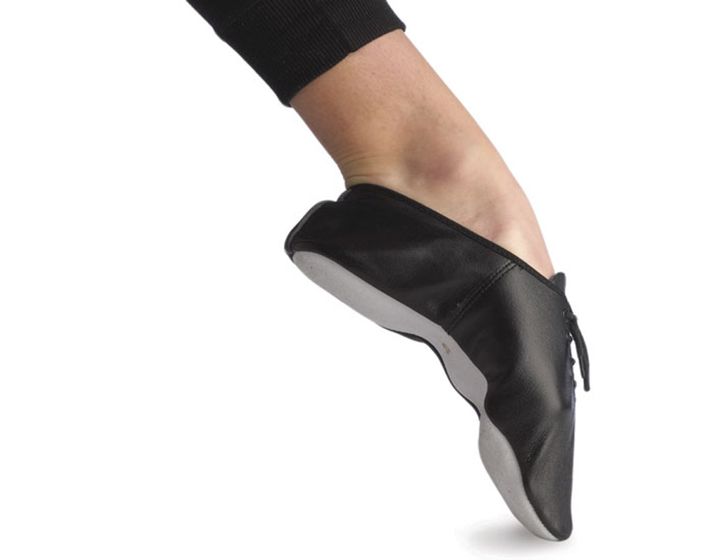

thank you for this tip!:Lighten: Certainly it may help! Following your explanation, I went to a sports store and I took some measurements on french made jazz shoes (with padded suede sole) :
I measured three pairs, in french sizes 34, 35, and 36. Here is the result:
34: 8" Long, 2 6/8 wide (on the widest part of the sole).
35: 8 3/8 L , 2 7/8 w.
36: 8 6/8 L , 3"w.
As I already knew, the difference from a size to another one is more important on length than on width. ;)
