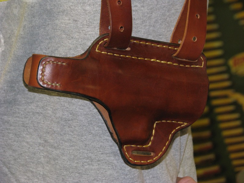

Members troop Posted December 23, 2011 Author Members Report Posted December 23, 2011 this is the pattern i've been using for several months now for the glock. it's about as good as i can make it look without over doing it. Tony Quote The hand that feeds you also puts the chains around your neck.

Members troop Posted December 24, 2011 Author Members Report Posted December 24, 2011 (edited) +1 sorry it didn't go through. here it is. Morning Tony, I don't see the pattern, maybe it's just me. My dept uses Glocks and has for many years. I hated to switch over from my mdl 19 Smith but have come to love my Glock. I'm just geting into holster making. I would like to see your pattern. Guapo here it is. Edited December 24, 2011 by troop Quote The hand that feeds you also puts the chains around your neck.
Members Guapo Posted December 24, 2011 Members Report Posted December 24, 2011 Thanks, I have to disagree with you...that's a good looking holster. Muy guapo. Guapo Quote
Members Eaglestroker Posted December 24, 2011 Members Report Posted December 24, 2011 Troop, I just did my first Glock holster for my BIL not to long ago. Strangely it turned out looking quite similar to yours, nice looking piece! Quote
Members troop Posted December 24, 2011 Author Members Report Posted December 24, 2011 thanks Guapo, eagle, i think you may find that most glock holsters are going to look similar, because there really isnt a whole lot you can do in regards to the molding. i think this is due to the plainness of the gun itself. seems the only place you can really have some individuallity is in the pattern of the holster itself. this holster in particular is of a g26/27/33. for the larger models, i narrow the sides in towards the bottom to try to create a little difference and individuallty in my glock holsters. ill post a pic of what i mean in the nest day or so. Tony Quote The hand that feeds you also puts the chains around your neck.
