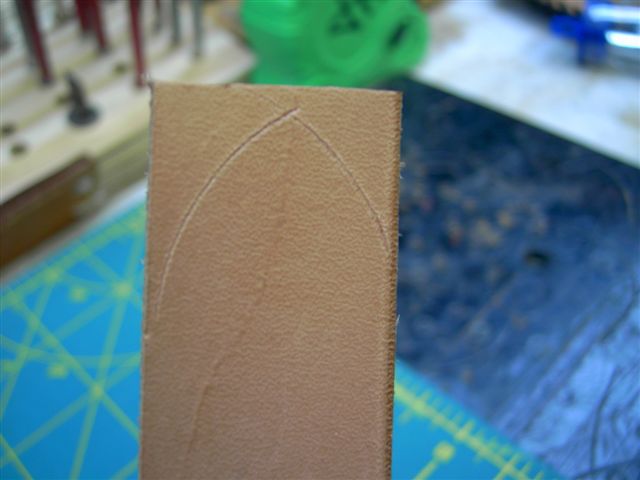

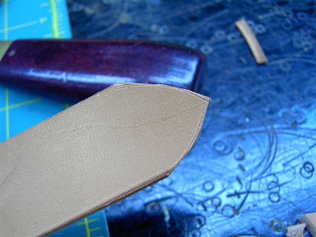

Here is how I cut strap pionts.
Set your dividers to the width of the strap to be cut.post-5889-040151300 1325118356_thumb.jpg
Set your dividers along side the strap and swing them in an arc across the opposite side of the strap.
Cut with your edged weapon of choice, I use a head knife and make a series of straight cuts to my scribed lines.
After a quick sanding job there you have it.....

Hi Jeffzilla,
Spot on tutorial! This info has solved the big problem I was having when scribbing the cathedral with my compass. I keep loosing the points of reference for the bottom points and consequently the tip of the arc when swinging the compass leg because I find it hard to keep the stationary leg from moving around (I thought my compass was wonky). I have the exact same cutting board as in your photos so now I know to use the grid to help keep postion, huzzah! Also, thanks for explaining your cutting technique.
I think this tutorial is definitely worth putting into the leatherworkers.net tutorial section, I looked there but didn't see one on this particular subject.
Thanks again,
yankeeinoz
