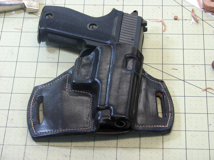

Members malabar Posted January 13, 2012 Members Report Posted January 13, 2012 It would be much easier to diagnose a specific issue if we saw a photo of the holsters you are producing. tk Quote
Members Dieselman Posted January 13, 2012 Author Members Report Posted January 13, 2012 (edited) It would be much easier to diagnose a specific issue if we saw a photo of the holsters you are producing. tk Ok, but go easy on me, I know it's ugly and i still got a lot to learn! That said, here it is. I feel like I got the leather contoured deep into the trigger guard and ejection port, yet when I turn the holster upside down, the gun just falls right out. The leather just isn't very stiff. Edited January 13, 2012 by Dieselman Quote
Members katsass Posted January 13, 2012 Members Report Posted January 13, 2012 Ok, but go easy on me, I know it's ugly and i still got a lot to learn! That said, here it is. I feel like I got the leather contoured deep into the trigger guard and ejection port, yet when I turn the holster upside down, the gun just falls right out. The leather just isn't very stiff. FWIW from the old grump; You have a few problems. Right off the belt loops are way too low. That shooter will start to lean out away from you --- SOON. The muzzle will dig into you and the butt will hang out away from you. The leather covers the mag release which can leave you with egg on your face as the mag drops to the ground as you come on target. Bad if you are working on the range --- deadly if you were to be in need as a personal defence weapon. Your stitching is nonexistent along the top of the slide and isn't any better on the lower side. Stitching on both sides needs to be close to your shooter --- it provides the initial portion of the retention, molding adds the rest. The 'contour' inside the trigger guard Is something I would do with only a gentle hand. Too much and you CAN cause the trigger to do things at times you would not like, and to totally rely on mechanical safeties is not always wise. Also, if you think about it, every time you draw or reholster the weapon, you push that deep molding out of shape anyway. I enclose a pic of a little pancake holster done by me way back in the '60s ( before I was more informed on some things) but it shows where the stitching needs to be. This one rode a bit too high also, but being for a Llama .380 (a mini 1911 in most ways) shows some of what I have mentioned. There are other things, but these items are the most important I feel. Hope this helps. Mike Quote NOTE TO SELF: Never try to hold a cat and an operating Dust buster at the same time!! At my age I find that I can live without sex..........but not without my glasses. Being old has an advantage.......nobody expects me to do anything in a hurry.
Members leatherjunkie Posted January 13, 2012 Members Report Posted January 13, 2012 FWIW from the old grump; You have a few problems. Right off the belt loops are way too low. That shooter will start to lean out away from you --- SOON. The muzzle will dig into you and the butt will hang out away from you. The leather covers the mag release which can leave you with egg on your face as the mag drops to the ground as you come on target. Bad if you are working on the range --- deadly if you were to be in need as a personal defence weapon. Your stitching is nonexistent along the top of the slide and isn't any better on the lower side. Stitching on both sides needs to be close to your shooter --- it provides the initial portion of the retention, molding adds the rest. The 'contour' inside the trigger guard Is something I would do with only a gentle hand. Too much and you CAN cause the trigger to do things at times you would not like, and to totally rely on mechanical safeties is not always wise. Also, if you think about it, every time you draw or reholster the weapon, you push that deep molding out of shape anyway. I enclose a pic of a little pancake holster done by me way back in the '60s ( before I was more informed on some things) but it shows where the stitching needs to be. This one rode a bit too high also, but being for a Llama .380 (a mini 1911 in most ways) shows some of what I have mentioned. There are other things, but these items are the most important I feel. Hope this helps. Mike yep i agree. the trigger area is molded way too much. you get in a hurry and stuff the gun into holster and the molding may cause trigger to go off. very bad for your leg. also you need to stitch around the form of the gun minus the barrell opening and handle opening. the stitching will add retention to the holster and keep gun in place. my holster instuctor said to draw outline of gun on paper. measure the slide thickness divide by 1/2 and add thickness of one piece of leather to that equals the stitch line placement. excample slide thickness is 1" / 1/2 = 1/2+ 1/8'(thcikness of one leather)=5/8" now draw a line 5/8" from outline of gun on paper slide side and trigger side. this is your stitch line. glue and stitch in this area. wet form after glueing and stitching gun will stay put better. also move your belt slots closer to the top of gun more. Quote keep it in the 10 range or at least hit the steel.
Members Dieselman Posted January 13, 2012 Author Members Report Posted January 13, 2012 Excellent! I appreciate the critique, it has certainly shed some light onto problems that need to be corrected. Now I will go back to the table and build another one and apply this knowledge. Thank you, James Quote
