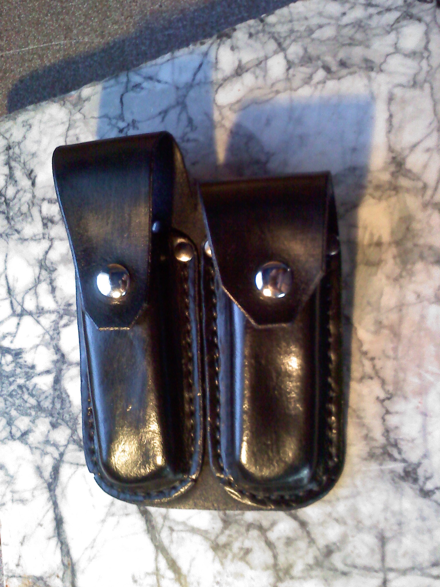

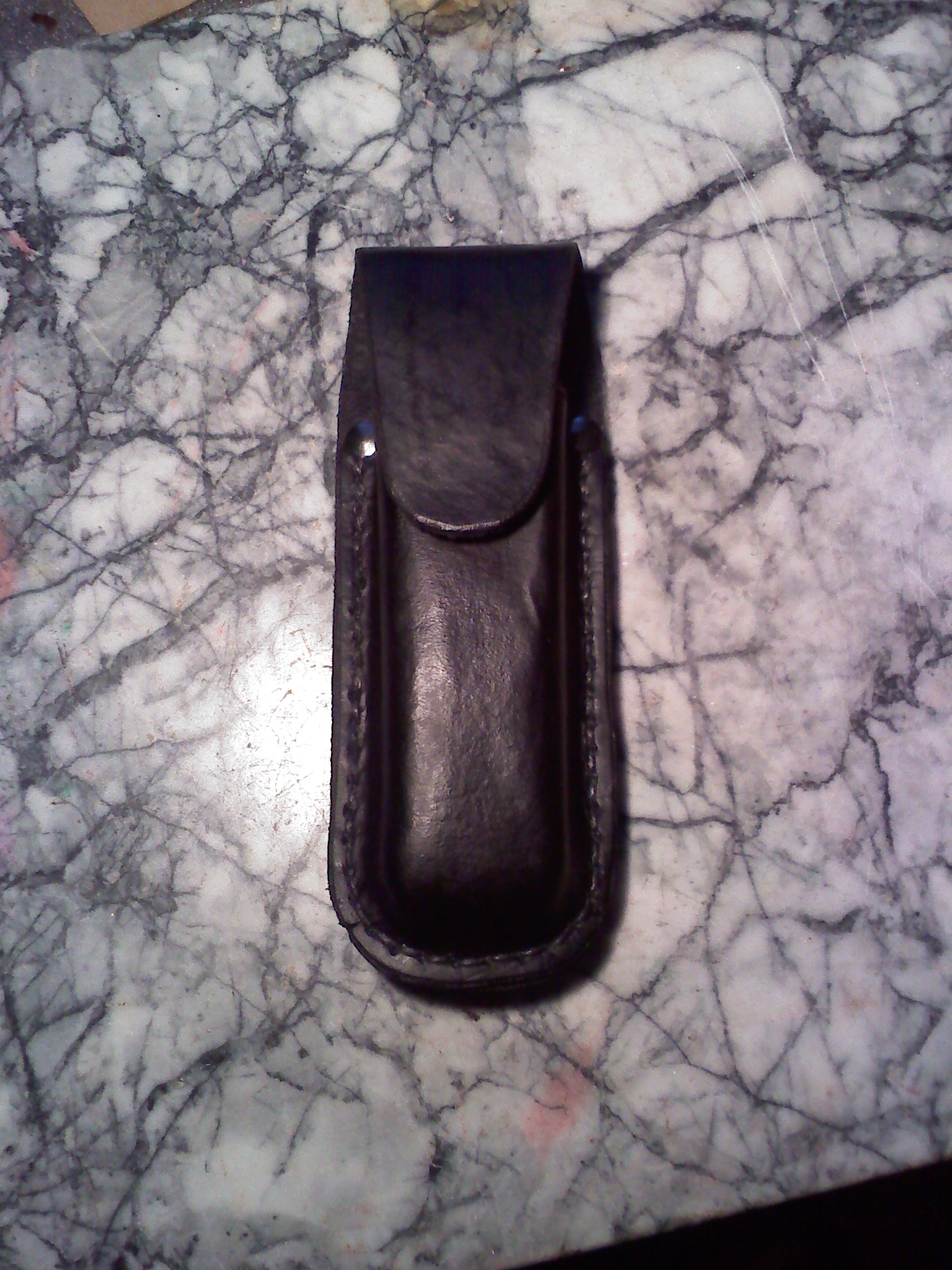

Members gaRYW5 Posted February 18, 2012 Members Report Posted February 18, 2012 Here are couple of different ones I made.The single one has velcro on the flap,the double one is for a 10 round and an 8 round side by side. Maybe this will help you. Quote
