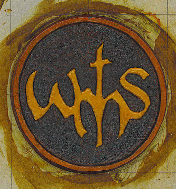

Members Artimus Posted September 18, 2012 Members Report Posted September 18, 2012 This is Mahogany oil dye and two coats of "Resolene" as a resist. (and dab the dye from the resisted areas quickly) Quote Practicing with an Etsy page here -----> ETSY

Members HellfireJack Posted September 18, 2012 Members Report Posted September 18, 2012 You would want to use a more effective resist than acrylic for "ooops" type issues. Latex rubber would probably provide better protection. There's a how to here on the forum. http://leatherworker.net/forum/index.php?showtopic=11101 Quote
